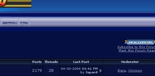

search
that animated gif makes me crack up everytime. :D
