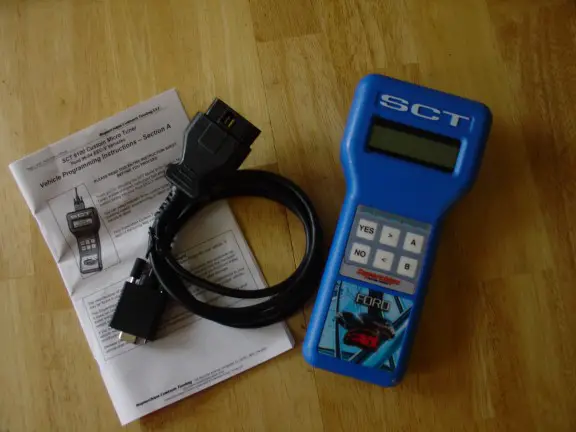

Are there any cheap scanner/programmers that does the stuff like adjust the computer for a change in tire size?
