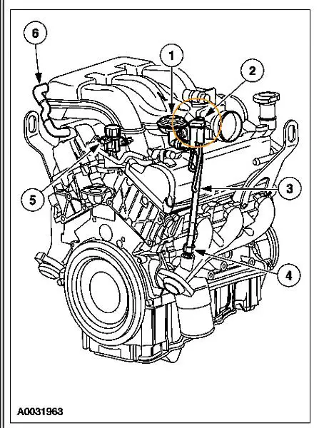

I'll try to find a picture of the DPFE stuff--
Here ya go
#1 is the egr valve
#2 is the DPFE
#3 is the egr tube--see the smaller tubes running off it?
#5 is the egr vacuum regulator (switches vacuum to the egr when the PCM calls for it)
If flow is not detected By the DPFE, you will get a p0401 code-but as you can see there are several more likely suspects then the egr valve itself.
Now that we have gone through all of this, you'll probably be the one in a thousand that do have a bad egr valve--ha ha
