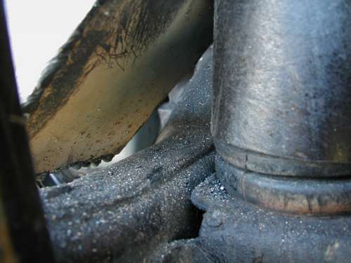

here is a pic from below showing the clearence between the support and the frame rails....

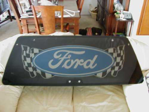

Here Is one more pic for thought.................. This Is my rear hatch window. That is a custom Tint Job on the window....... No it's not a sticker.... Yes, I said All Tint! I am also getting the two side rear Qaurter Panel windows done with a Trick design but youll have to wait to see those till its running which will be soon!!

Did you put tint on the outside of the window?
thats a very nice rear window. did you do that yourself or can most tinting places do that? thanks
No. It is window Tint it goes on the inside. It is all on the inside.
No I wish I could do that. A freind of mine did it for me. He is a window tint Professional. Most shops can NOT do that quality tinting. This type of tint work is custom and it is not cheap.
Just one more thing... The reason for doing this in Window tint rather than using a sticker or something is that You can still see right through the window from the inside, It does not affect your vision whatsoever.

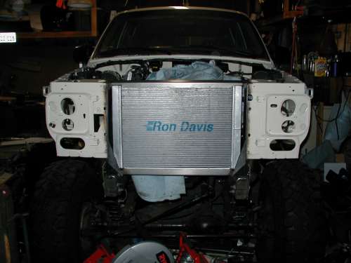

So here is a pic of the Radiator in its new custom front support which I did make:)

Chief, With a radiator that big, have you thought about running a electric water pump? CSI makes a pump that's rated at 30 gallons per min.
Yeah actually I have thought about it, but the reason I decided not to go with that is because well, for one they are expensive. The other reason is they stick out pretty far, so far actually that they stick out further than the stock pump and pulley do. Since I have spent so much effort trying to get enough room for nice e-fans behind the radiator I dont want to give up the option for the electric water pump.
Is that radiator big? :eek: :D :D :D :rolleyes: heh heh
