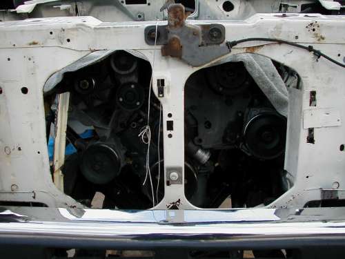

So I modified the front some more. I broke out the cutting torch, welder and grinder and got a little carried away. Wait no I mean a lot carried away!!! Hell, This will have more airflow than a jet!! :D
...Here is a before.... So you can relate.
Here is after...........

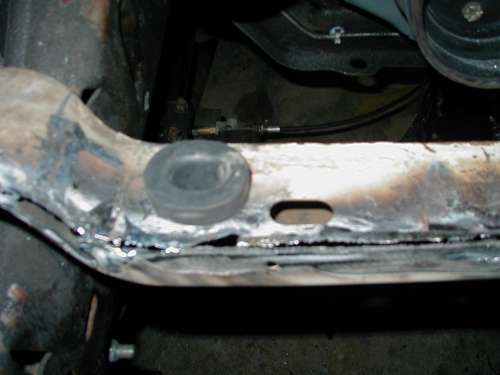

This pic shows the old radiator grommets and brackets. I cut these out and made some new holes for the grommets tucked under the front support....
here is the hole for the new location....
Here is the new grommet in place.....
