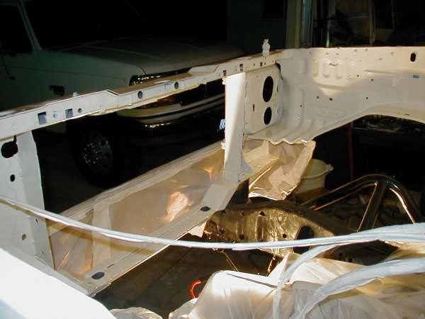

Anyway.... After that The next step was to change my water pump and timing cover for the 95 water pump and timing cover... This was succesfull and involved pulling the harmonic balancer and oil pan. After doing that I gained about 1 3/4" in the front for my fans....
Then the motor was set it and tranny, T-case and Driveshafts were hooked up to situate the engine for the last time....
After we got everything in the perfect spot. I welded in the lower half of the motor mounts. The engine was positioned as low and far back as possible, while still leaving room for flexing during off road situations....
Only one thing does not have much room and that is the smog pump. I am not going to have it on there anyway except for when going to the smog station! but here it is....
everything else clears fine....

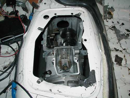

So the next hurdle was my crossmember. the T-case ended up being a little further back than before because of my engine placement. I am debating on sending back my AA for the shorter one or modifying my crossmeber. I will have more on this within the next few days.....
Here is a look at my gear shifter location.... It wont change with or without a shorter AA piece. It is a little far back for my liking, but I will most likely have to modify it a little to clear my center console. This again all has to do with my engine placement, But this is all to get my huge dual E fans in between the rad and engine! It will be worth it and it will look awesome.

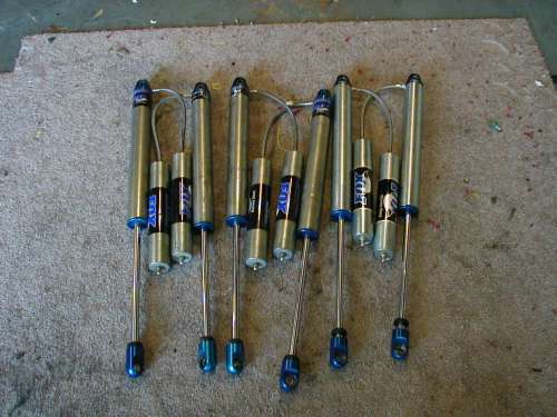

Oh, here are some of my new toys!!!
I got 2 new fox shocks. These are for the Rear of my truck. I am going to make brakets and everything for them and I will post all about that as well.
The new ones are on the right (look how clean;)

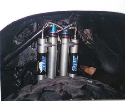

And this you wont believe this will make yopu drool.....

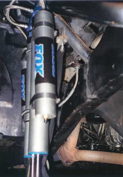

My new billet shock mounts!!!! these hold the shock resevoir to the shock. There are 2 per shock...
Here is a pic of before... you can see the rinky dink hose clamps with the little rubber grommet between them. This is replaced by the new mount....
shoot you cant se it very well in that.. hold on...
there we go.... Anyway those are replaced with theeeeeeeeeeessssseeeee
another view.........
