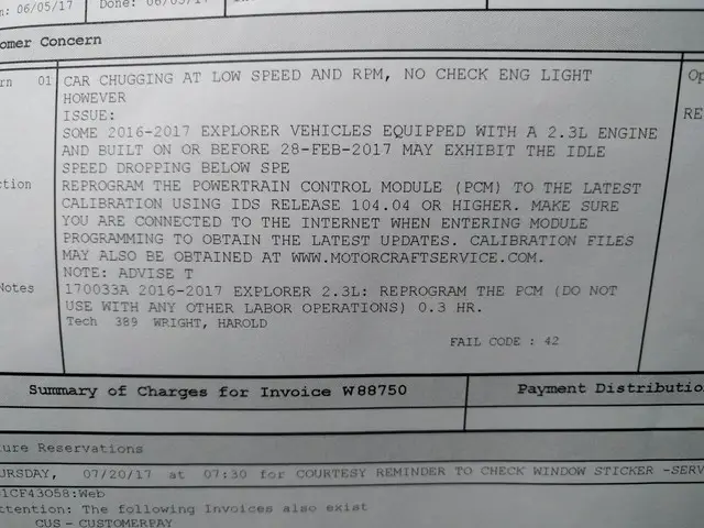

I gave up and took the Explorer back to the dealer to have them look at it again. This time , I didn't get the "just use premium gas" answer from the rep and they reprogram the PCM in response to a TSB 17-0033 . Work order attached. I'm happy to report it's much more better now. Less chugging at slow speed
Some 2016-2017 explorer vehicles equipped with a 2.3l engine and built on or before 28-feb-2017 may exhibit the idle speed dropping below specification after repeated light pedal tip-in/tip-out events at low vehicle speeds, such as in heavy...
