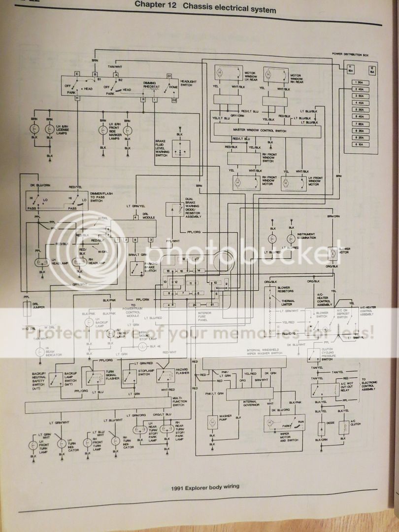

I have a 91 ford explorer. I recently had to change the headlight switch because part of the connector burnt (specially around pin B2/A on diagram). I also changed the connector. Both of them are now brand new.

For the body wiring, see link below:
http://i1325.photobucket.com/albums/u625/lighterTom/IMG_0080.jpg

Question did you find and fix what made the headlight switch connector burn? I am betting you felt it was just the switch and so just replaced it.
That said its sounds like you may have had a wire or two that got hot melted the insulation and are now cross feeding. I get battery voltage at my lighter. a possible location for this cross may be right by the ash try as there is a dash light there and the lighter wires also so being there at lest thats were I would start and then work back to the switch.
voltage at the lighter s/b battery voltage (12+ to 14+). it sounds like somehow you lighter socket is getting it's power from your light switch. you could figure it out, but i'd just run a new wire (with an inline fuse) straight from the battery to the lighter.
