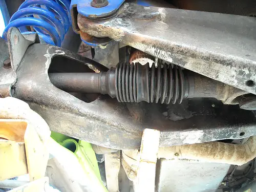

That boot holds onto the axle more than you expect. You need to get the boot off first, then yank, pull, swear etc at the shaft. You may even try spraying some pb-blaster type stuff into the slip joint since it is probably very dry and corroded. Here is the "boot" location I'm talking about. This is ours with the rack and pinion bellows boot over the slip joint.

You can see how dry/corroded it gets. This pic is from our '92 and we live in Southern Az where there is no rust. That pile of "dust" on the ground came from that slip joint. I can't imagine how it would be in some place where they were rust.
