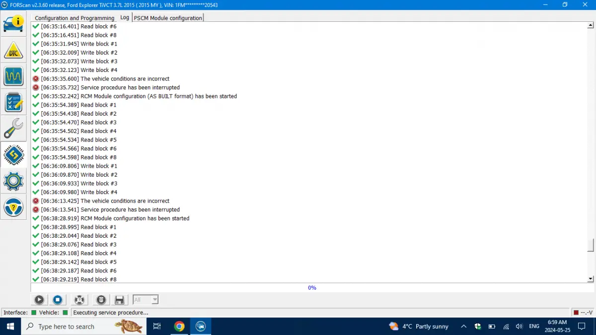

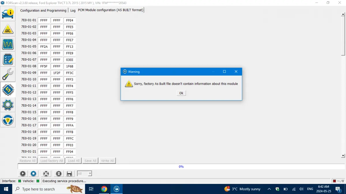

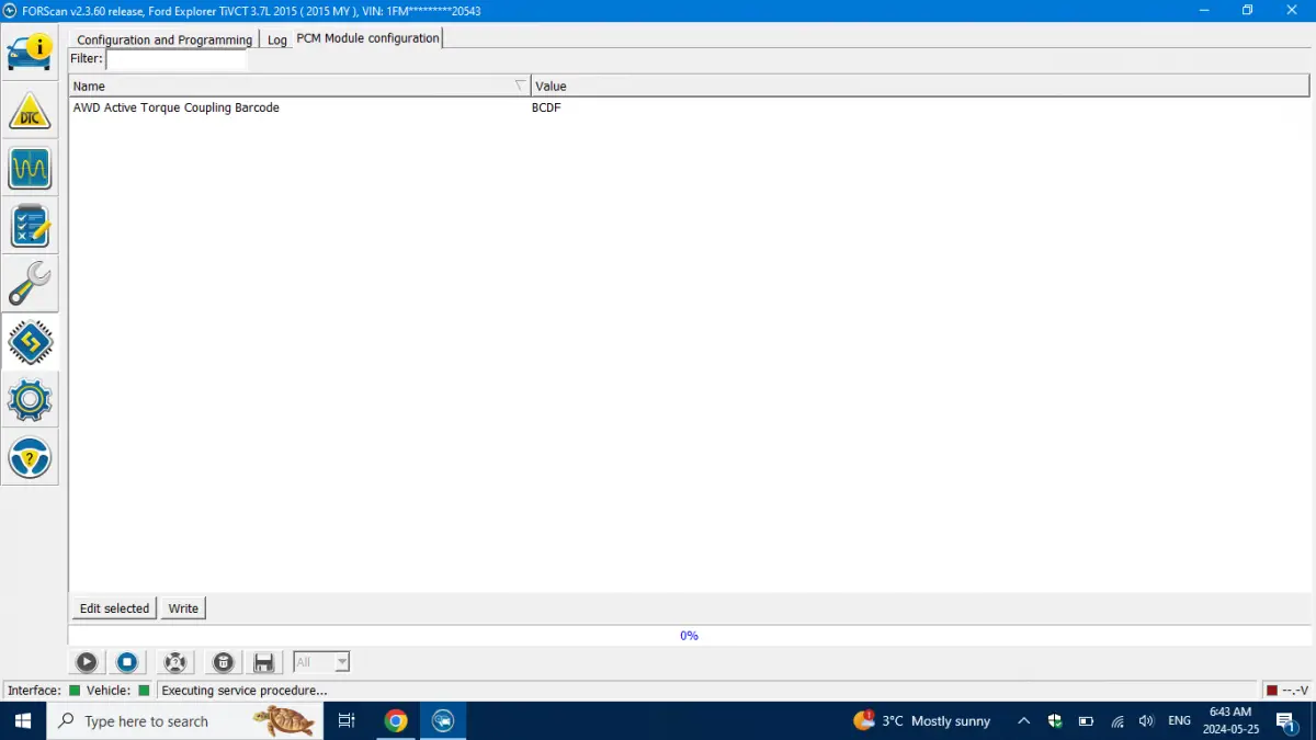

First, I'd like to clarify the issue that many people have wondered what it has to do with (AC- HVAC - 'AWD Torque Coupling barcode' - 'The tag for the shift solenoid') My response is that I initially thought I had messed up the configuration of the PCM data module As-built, and when I tried to load it, it wouldn't let me.....That's why my mind went in a different direction and many more.

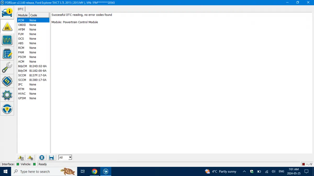

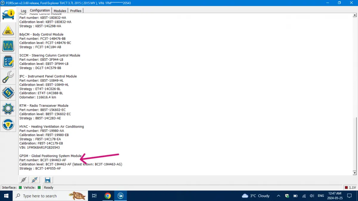

Yes, I compared it to Forscan, and it's identical. All this, thanks to your help, I also found the perfect match with the AWD Torque Coupling barcode. Moreover, I finally identified my biggest issue: the AC air vents, which had been non-functional for a long time. Was just bad connection.
That's why it was intermittent - sometimes it worked, and sometimes it stopped. The culprit was a bad wire connection, which move when I drove.
