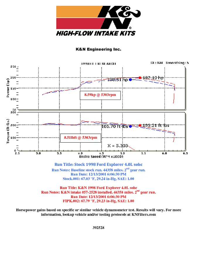

+3. No intention of getting involved in another factory vs. aftermarket intake discussion, but unless you are accelerating or driving over 4000 RPM, that "whopping" 8.59 HP gain @ 5303 RPM doesn't come into play. Neither will fuel economy, especially at those high revs. That's why K&N doesn't claim MPG gains. Clean, used 4.0L SOHC air boxes and intake parts should be abundant in most salvage yards for very reasonable prices. Use a new panel filter, and remove the air "horn" silencer if you want a slightly louder intake sound. Done.
