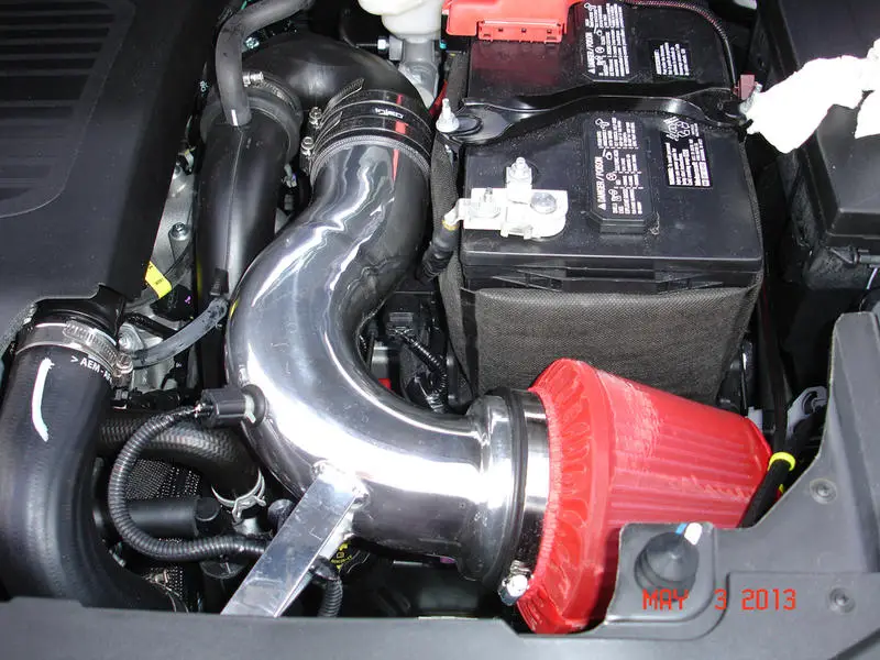

Harley...
the intake I ordered and installed did not come with a heat shield.
Thanks for the info.
I'd love to do some testing with a remote temp sensor to see what engine bay temps are in various spots. With as sealed as our engine bay is with the hood sealed with a gasket, and the grille half blocked off, I'm interested to see how the air temp varies from the intake scoop to the airbox, vs. just the open engine bay to see if a heat shield even does anything in this application. I was surprised how much the engine bay holds heat after popping the hood last week after only driving 5 minutes to the store, and 2 hours later when I popped the hood it was still cooking hot under there.

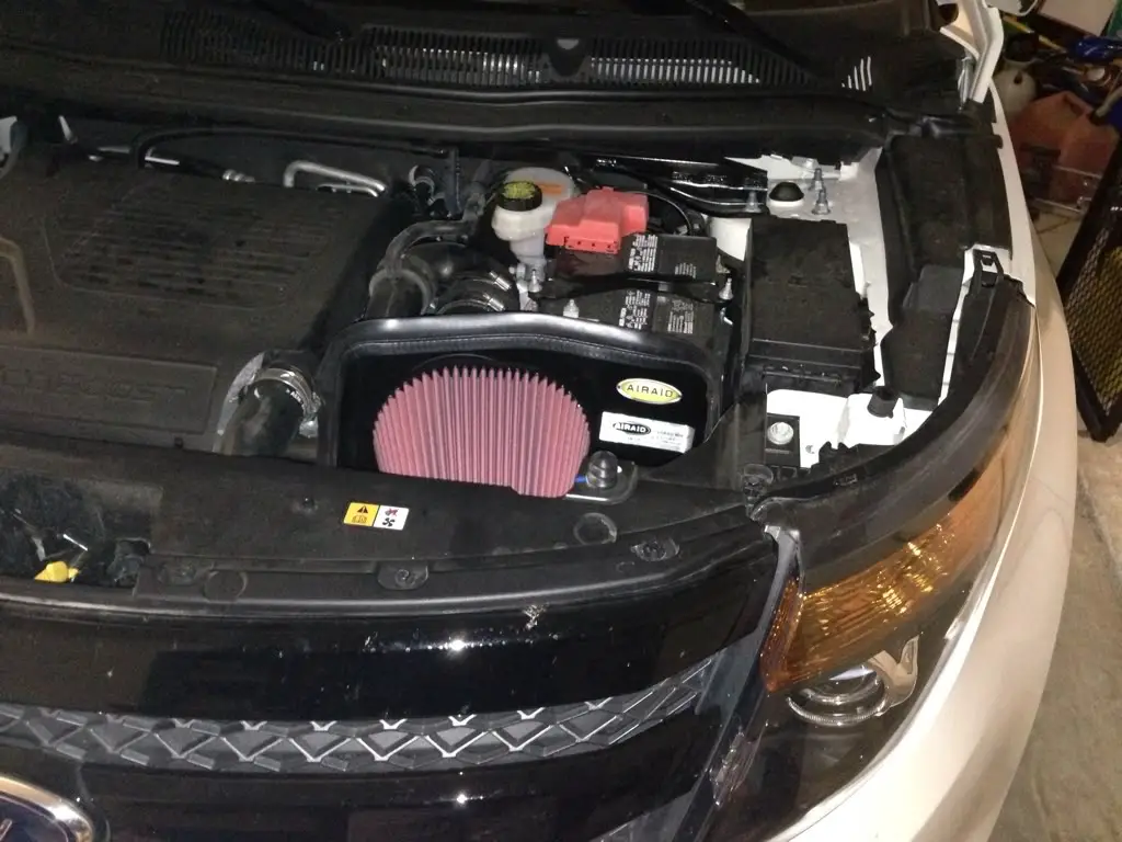

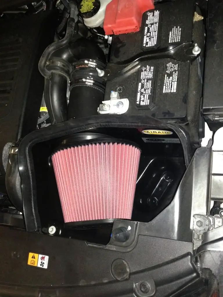

Just installed my airaid for a SHO in my 2013 sport. Perfect fit, fit like a glove.
Hi Drwalker02, Knowing that the Airaid is designed for the Taurus SHO, does the hood of the Sport seal down tight against he weather stripping on top of the air box like it is designed to do on the Taurus?
It wouldn't surprise me one bit if that seal didn't touch the hood on the taurus either. I've seen so many "sealed" airboxes over the years and barely any of them actually seal against the hood, but that piece of weatherstripping gives some peace of mind thinking they do.
Easy check... Put baby powder on weatherstripping and close hood, open and see if it left a mark.
