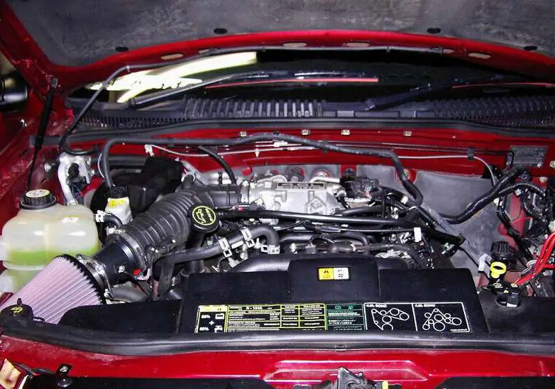

I got the intake in the mail today and installed it in about 15 minutes. Looks good and seems to breath better. With that the X has the BFG's 265/75/16's, Cold Air Intake, Exhaust, Clear Corners, JVC indash dvd, Monitors behind the head rests and I'm ordering the monitors that go in the headrests asap.

cool, you have any pics of the intake installed?

That looks good (the air filter) - how did you mount it though as on my XLT, the MAF is moulded as part of the air box lid. Can you just cut it off and then attached the Pod?
well you can try to do that but how good will it work and how good will it look? The one I bought is made so that you take the MAF off the bx and it installs in the new air intake. KKM makes the only intake for the 2005 XLT thats what I have. Search KKM on google and then order it up. I searched the net crazy looking for a CAI for my 2005 and no one makes them except KKM.
