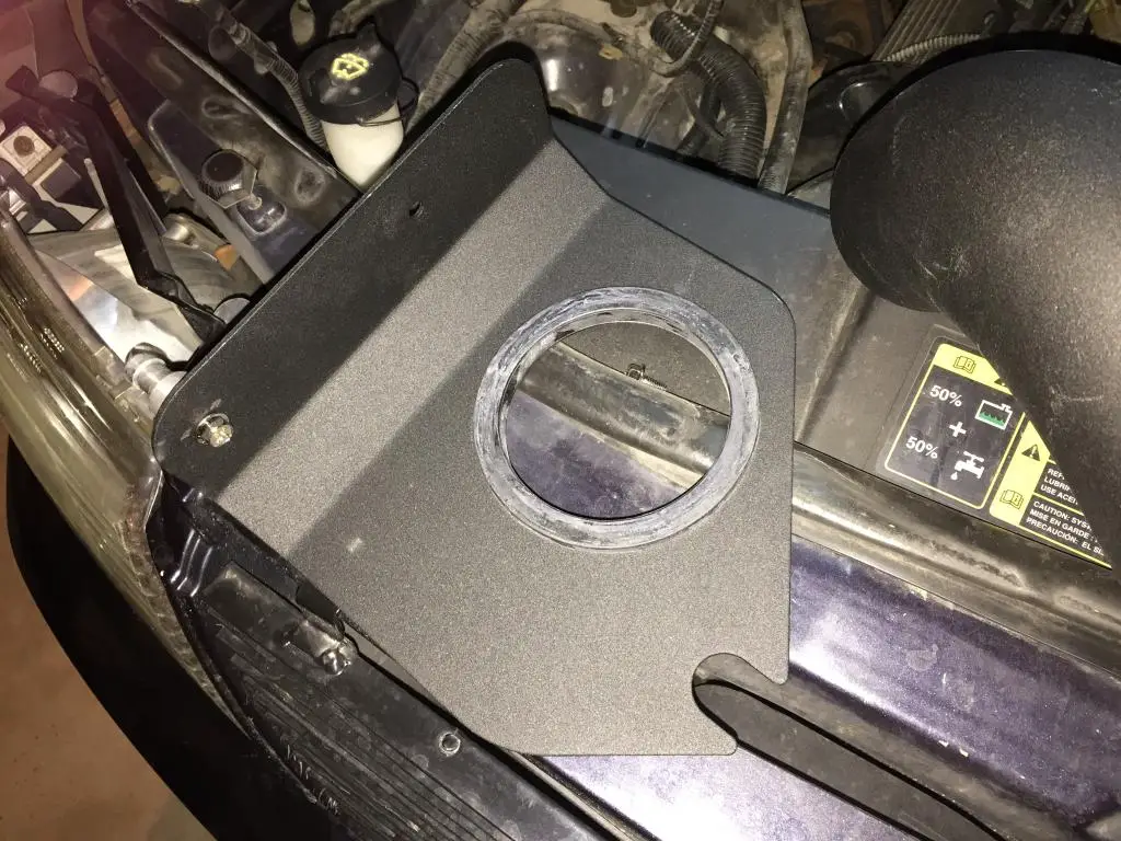

Step five: Take the support plate that comes with the kit. Place it in a vice and bend the L at the bottom of the plate 180 degrees to make it a mirror of its current configuration. The pic is before bending.
Step six: Take the modified support plate and mock it up to the existing air box mounting grommets. The mounting hole closest to the firewall will work just fine. I used two nuts between the plate mount and plate as spacers for this hole. The next hole will not line up so you will need to drill a new hole to line up with the other factory grommet. This mount will require more spacers due to the design of the fender apron. Once modified push the support plate into the grommets.

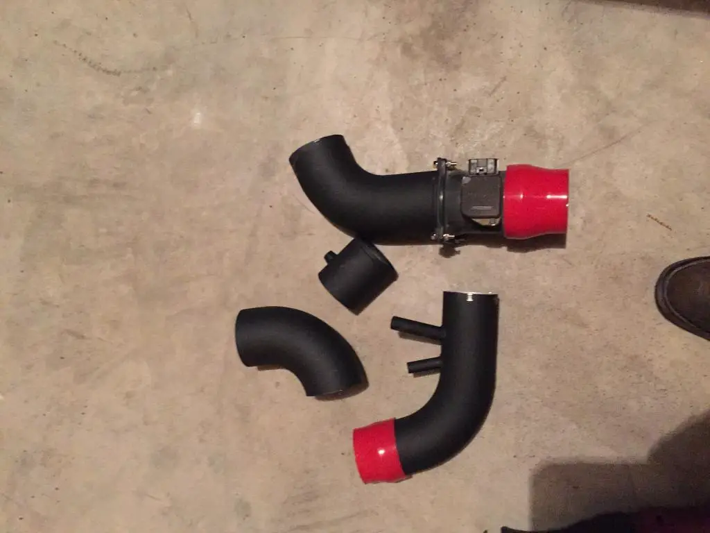

Step seven: Mark both pipes where they need to be cut, remove maf and couplers and cut pipes
Step eight: Slip the tube with the MAF sensor attached through the support bracket.

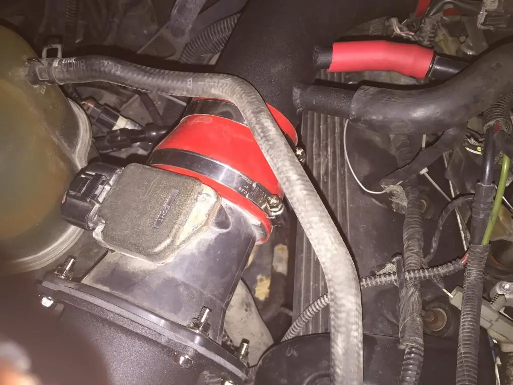

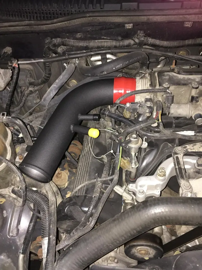

Step nine: Install the throttle body tube to the throttle body and maf sensor and secure clamps
You may have to run the coolant hose to the degas bottle over the top of the intake tube so it doesn't rub on the bolts for the maf sensor. The ideal fix would be to run a longer hose. Some may not have to do this.

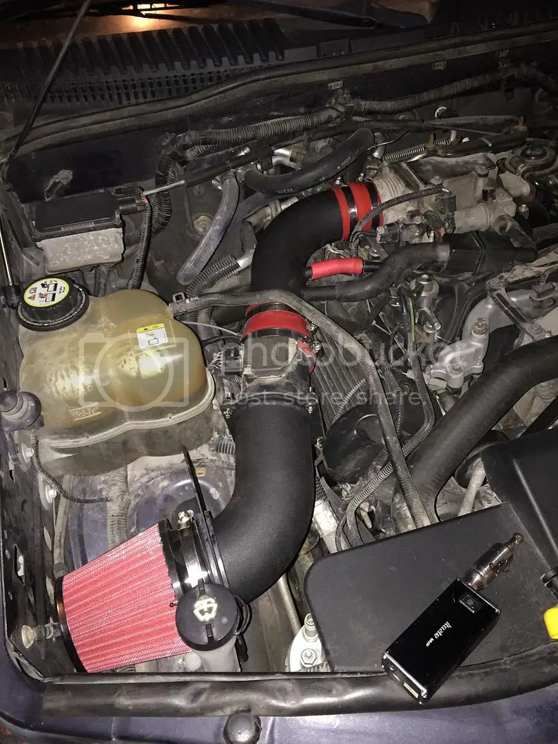

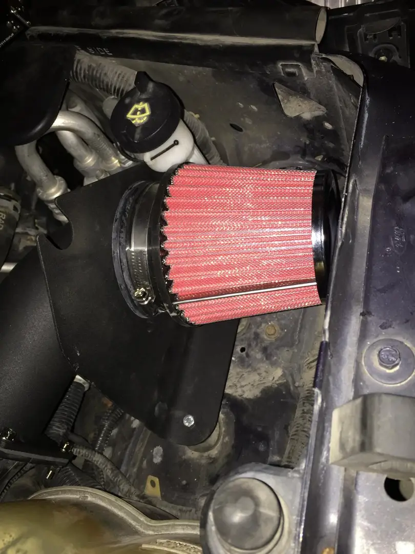

Step ten: Install Air filter, pcv hose, and IAC valve breather hose. Hook battery back up.
Finished
