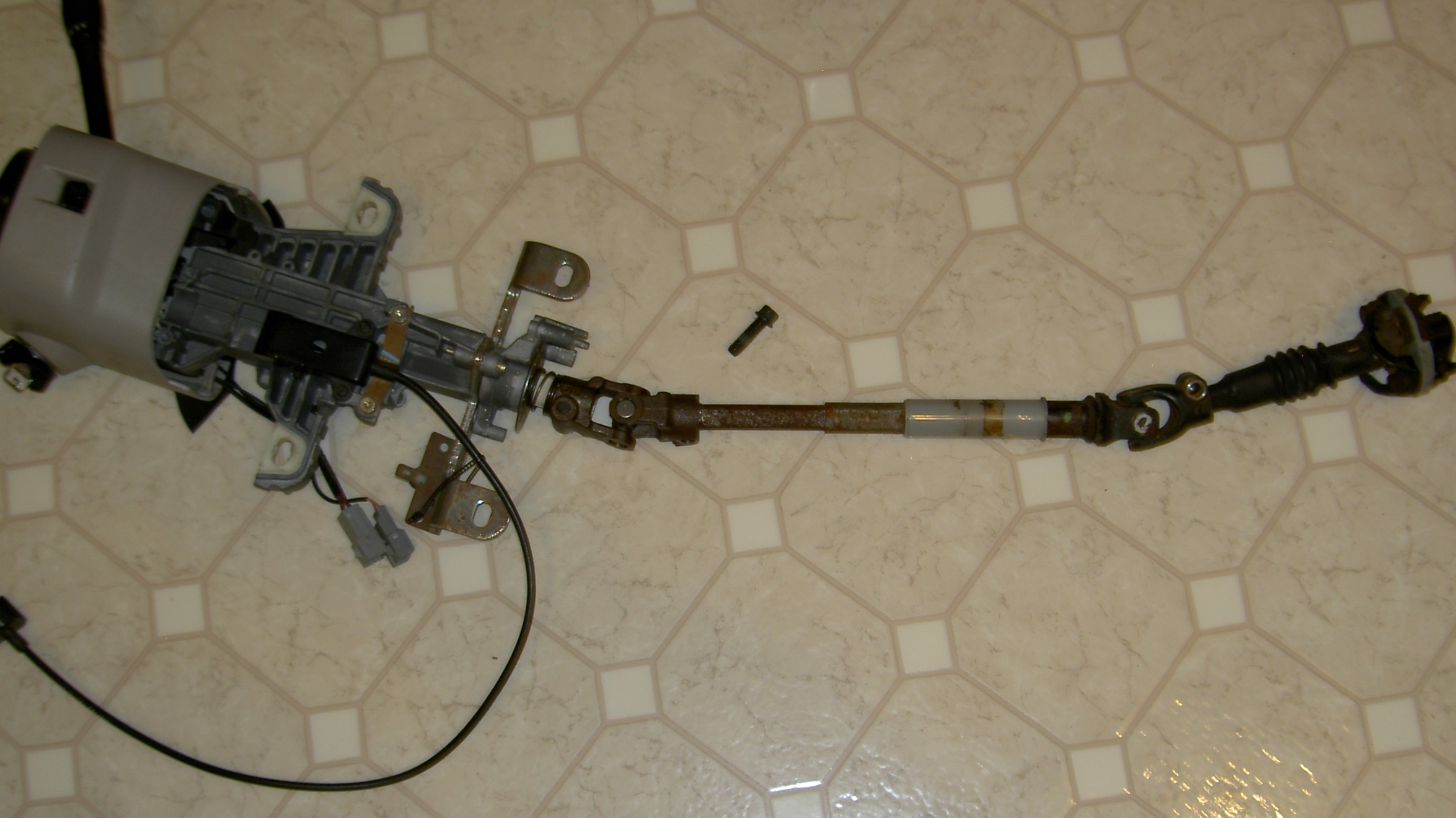

Based on your post I'd say that I need the lower shaft. I do have 3: the shaft in the column, with a u-joint for the tilt wheel. This is attached to a fairly short shaft that has a u-joint that the column shaft bolts to, goes through the firewall and has a short sliding section and ends as a square bar with a bolt hole in it. Finally, the lowest shaft bolts to the previous shaft, appears to have a telescoping section in the middle and attaches to the rack.
I can find nothing wrong with the first 2 shafts, starting at the steering wheel but the shaft to the rack will not telescope and, of course, is quite rusted. Like you, I believe that this shaft absorbed the brunt of the impact, collapsed into itself and is now jammed. So, I need the lower of the 3 shafts in the newer setup. In order to remove this shaft I must unbolt the top from the middle shaft ( a through-bolt) and then remove the pinch bolt at the steering rack. Will another year's (95-01) lowest shaft work in my '97?

It's the pictures in post 11 (Turdle). I really appreciate it if you could please take a look and let me know if this is the shaft that's interchangeable.

That will work, yes, I even have an older 95-97 shaft for mine I bought to test fitment of manifold with. They have been swapped before, you found some of those postings about it. I'm going to be fabricating a manifold set, and the older shaft takes up a little less space around the manifold area.
