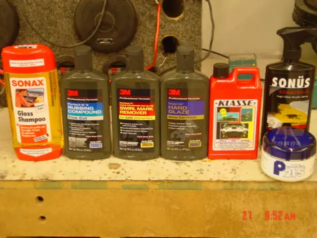

This picture shows the line-up of all of the products I am using.
