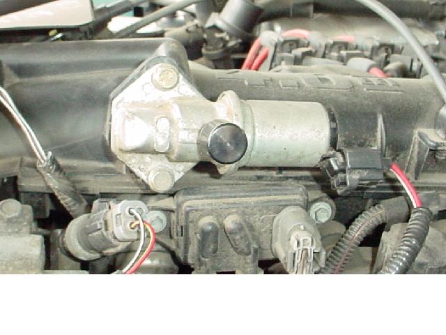

... where is the idle control sensor on the 91? Idle on my EB is all over the place... sometimes it's hard to start without giving it some gas... fuel injected doesn't need that...
A good possibility is that the IAC is shot. It's mounted to the side of the intake by the throttle plate. It controls the amount of air the motor sees on startup and at idle. After a while they get carboned up and cease to function properly.
I'll replace it then and see if it helps. I do have a spare one on the extra engine I've got... thanks.
Here is a picture of it:
