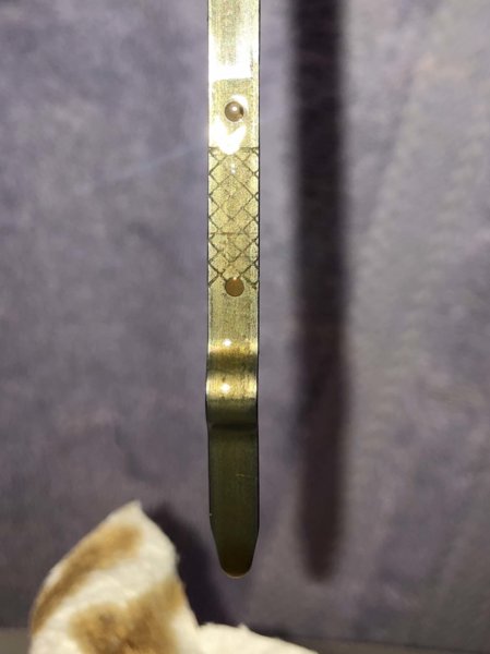

Are you sure? That would be about a quart over if 1cm above the max. Personally, I wouldn't drive it until that was resolved.
Sad thing is I drove it from LA to Sacramento and back plus 2000 miles more.
I guess the mechanics from the dealership just pour oil w/o checking the dip stick. It is not their vehicle anyways. I trusted the mechanics and now I am paying the price.
I even sent the picture to the service manager but did not hear from him today after hanging up the phone.
I may just stay within 3000-4000 rpm for now. I may have to replace the air filter and clean the air box to remove the oil from overfill.
Im tempted to just take it to jiffy lube though ...
I do have extended service that covers oil change from the ford dealership... given by ford usa after my complain.
Thanks guys. I hope this will resolve the cabin fume issue.
Don't expect anymore from the jiffy lube monkeys.
Whenever I have someone else change my oil I will check it before I leave their property. The stories about not filling it, overfilling it, and leaving the drain plug out are all true and once you leave the property it is mostly on you.
If anyone is still looking for info on exhaust smell in cabin, I have a 2018 3.5L Limited Explorer that developed the smell in the cabin on hard acceleration after the dealer did some engine repairs. I found the oil level was too high, when I lowered the oil level to normal, the smell went away. FYI (maybe its already been discussed).
I drained about 3/4 quart out to get normal dip stick reading.

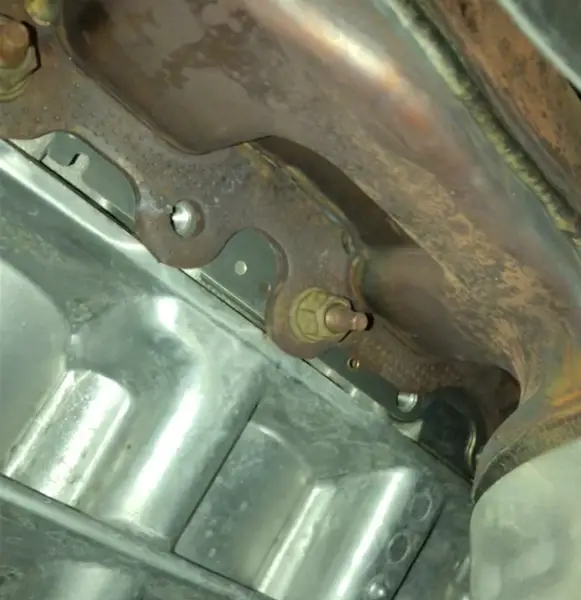

Update: Still have the exhaust smell in the cabin, but just exhaust smell after hard accel, 4000+rpm, and after accel to speed and let off the pedal. No burning oil smell thou. I checked the exhaust manifolds for leaks, but found what seems like missing bolts. See photos. How many bolts/studs should I have per manifold?
Found out mine was missing bolts in the manifold too. Put bolts in but didn't seem to make any difference.
Mine is missing in I believe the same location. I've known for a few years but never have done anything about it. I don't and never have had the exhaust smell.
