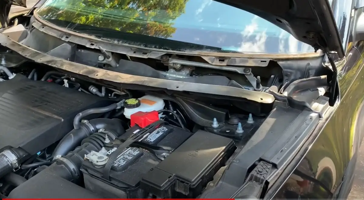

Then how is it the windshield? Ac etc comes from that area. It doesn't make sense. This is an intermittent issue from what I've heard. Its premature to say that whatever was fixed on your trim solved it.
If you have a leak somewhere you can end up with some bizarre happenings. A poorly sealed windshield might pull gas into the cabin from elsewhere, not at all related to the windshield area.
I did everything before for more than 2 years now. Whatever it is or if the windshield seal and new moldings fixed the issue I’m happy. I gave up long time ago 3 dealership tried to fix the issue.

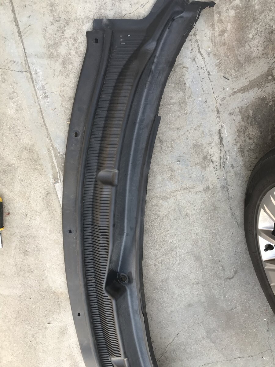

I was able to take a picture of the cowl grille but not the moldings and side trims.
Maybe my old windshield was leaking from the bottom or base. Now i have a new windshield and new sealant it stopped the fume from getting inside the cabin.
2-3 years old explorer’s rubber trims look like this :

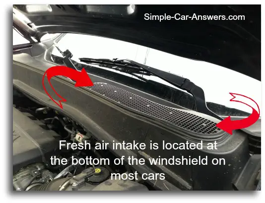

Hi.
Where exactly is that air intake located in 5th generation Explorer?

Can you please tell me where is it? Clearly not where OP said it is.
I wasn’t following and thought you meant the air intake for the motor. I’m not sure where the cabin air intake is. The cabin air filter is changed through the glovebox, you could probably follow it from there.

Thanks. Are these photos of your 2017 explorer fresh air intake being sealed?
I searched everywhere and could not find clear photos of that intake location and steps needed to reach it. All search results are about replacing the cabin air filter from behind the glove box :confused:

I'm in the same boat, where is the fresh air intake located? It's not where the OP references
