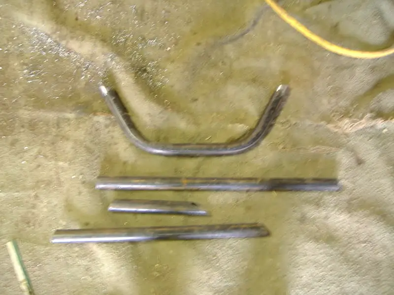

Got all the tubes cut and Just need to clean them up and the bumper will be ready to put together. Sorry for the blurry pictures.

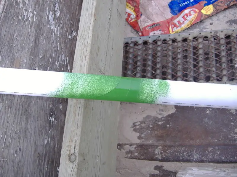

Marked a center line.
Lined up edge
Wraped around.....Perfect fit
Marked out where the cut will be.

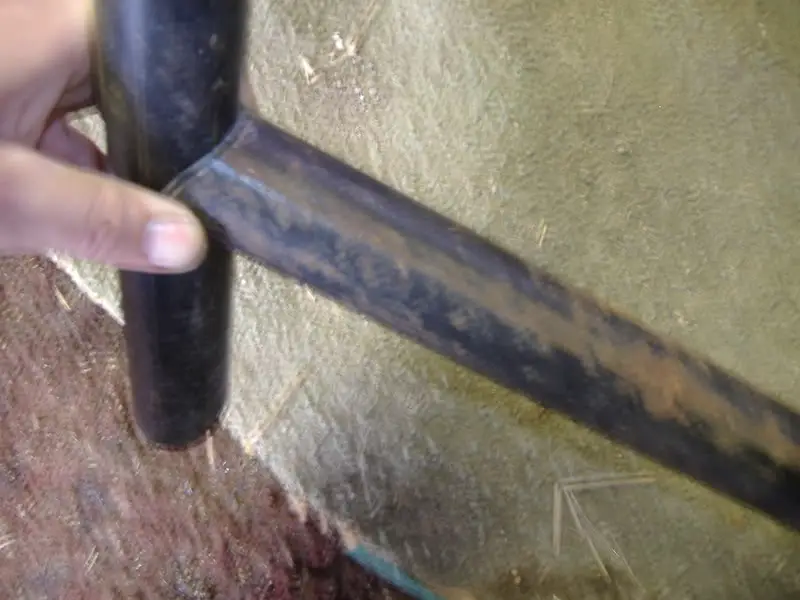

Here are some of the test pieces I cut.
Some of the bumper parts.
clean n' mean
