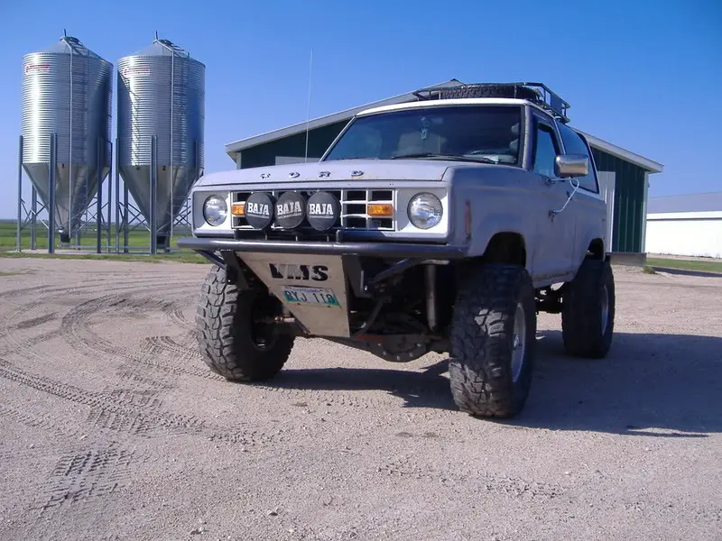

bumper is *****in, I love your truck... its like you had a plan and the execution of the plan is coming along really well! Nice work!

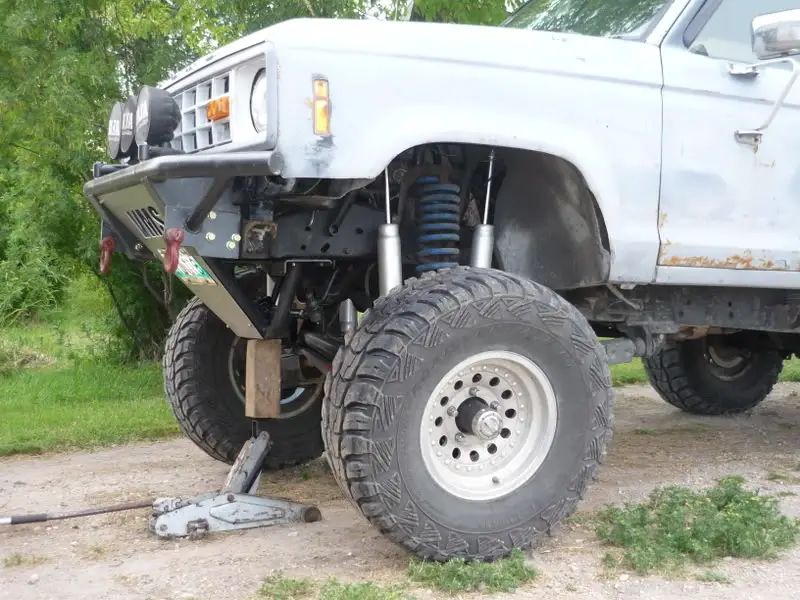

Yes Darting. As in driving straight then all of a sudden it wanders over to one side. Correcting results in over correction. Sometimes you can feel it twitch back and forth and your not touching the wheel. Most times it twitches to the passenger side first.
I got to measuring the caster a few weeks ago. Drivers side lower is roughly .68 forward of the upper. that translates to about 5° positive caster. The passenger side is roughly .94 forward which is about 8° positive. That makes 3° cross caster. I think that is too much. Now If I have a 1/2° bushing set to full negative camber/0 caster on the drivers side and a 1° positive camber/0 caster on the passenger side. I've now got 3° of cross caster. Should be able to do it with these new bushings.
I'll dump about 1/4° of camber so that the top of the tires are in more than the lower.

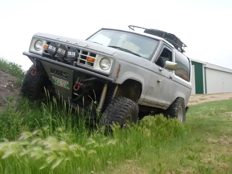

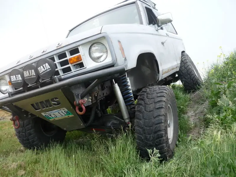

Here is some dry pavement video. You can see the tires are going positive camber.
http://www.youtube.com/watch?v=BZfpRTUBacc
Here is some gravel and they still go Positive.
http://www.youtube.com/watch?v=iBd9lE6Pntg

dang that thing looks reeeeeeeeealy good. i give it ten stars
lookin reaaaaaaaaaaal good

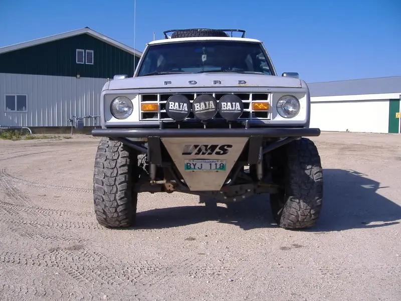

sweetness, truck looks so nice, totally custom 1 off BII unlike any other. Very nicely done, the bumper is sick!

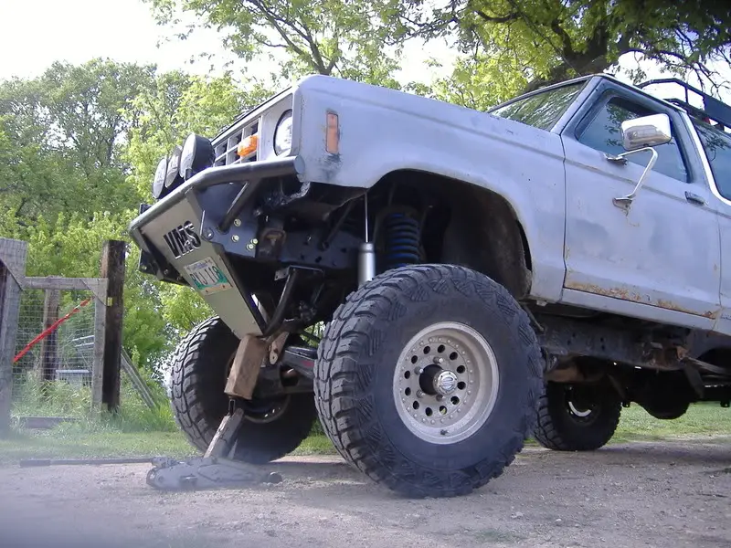

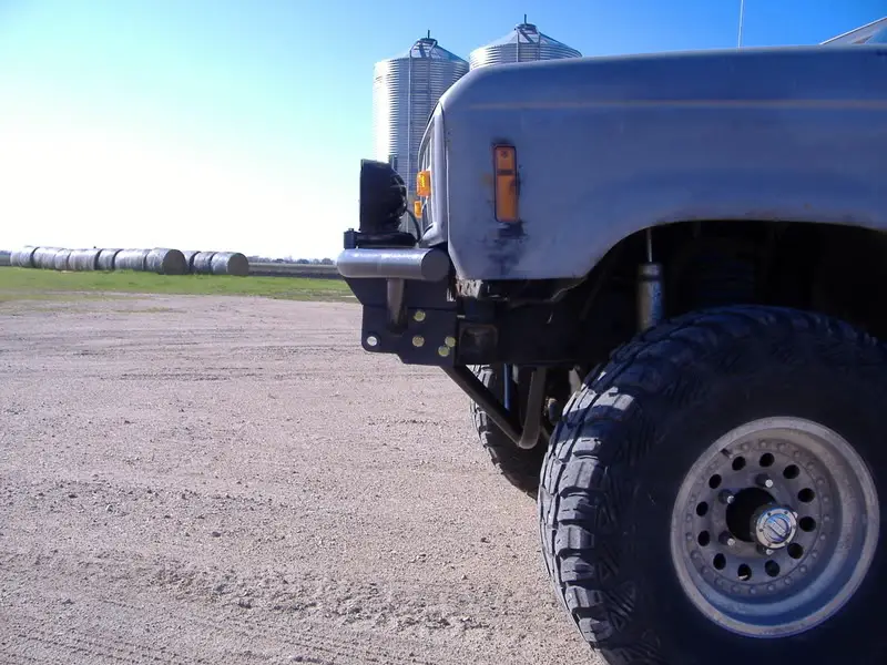

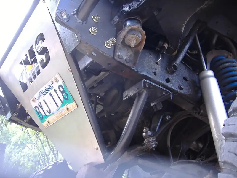

Better look at where the lower hoop is for the bumper. Yes it's welded to the old sway bar brackets.

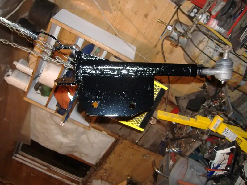

I reinstalled the quad shocks up front and put on my modified X2 superrunner linkage.
I've changed out the leaky PS pump and plumbed in a cooler. Changed out the locked up AC/OBA setup with a working compressor.
Stock linkage
Modded Superrunner

pics of the modded linkage please :D

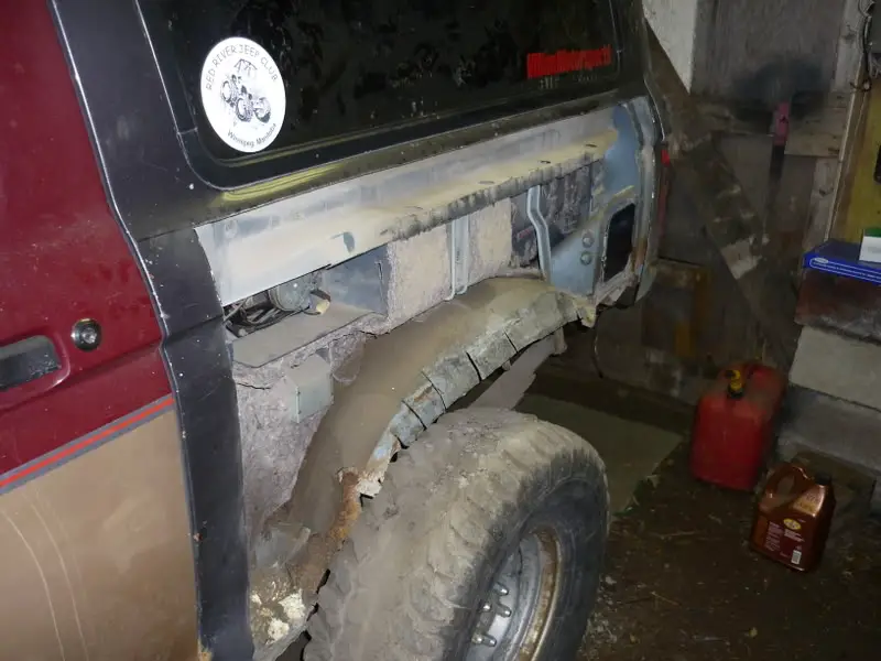

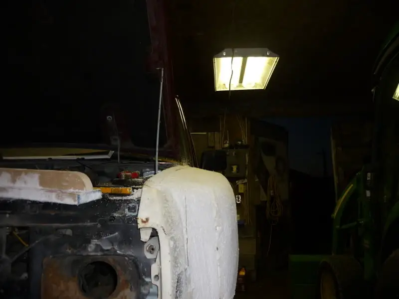

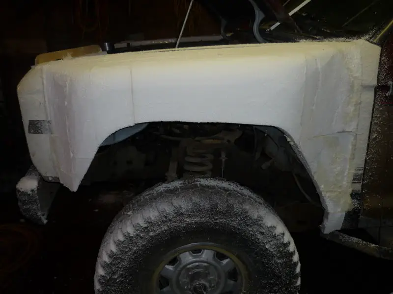

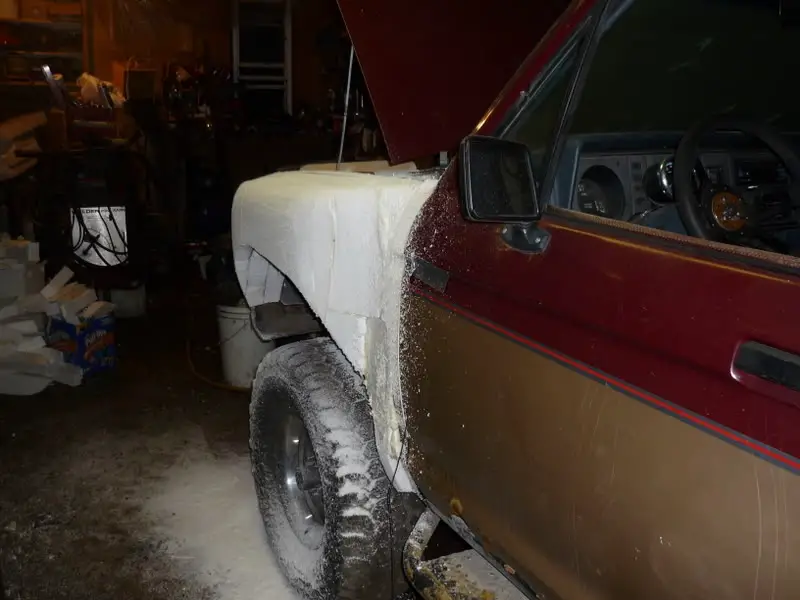

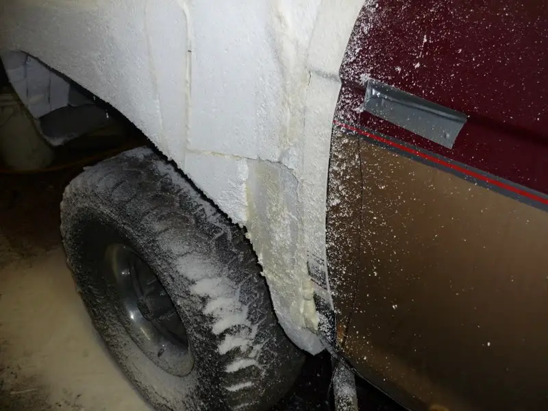

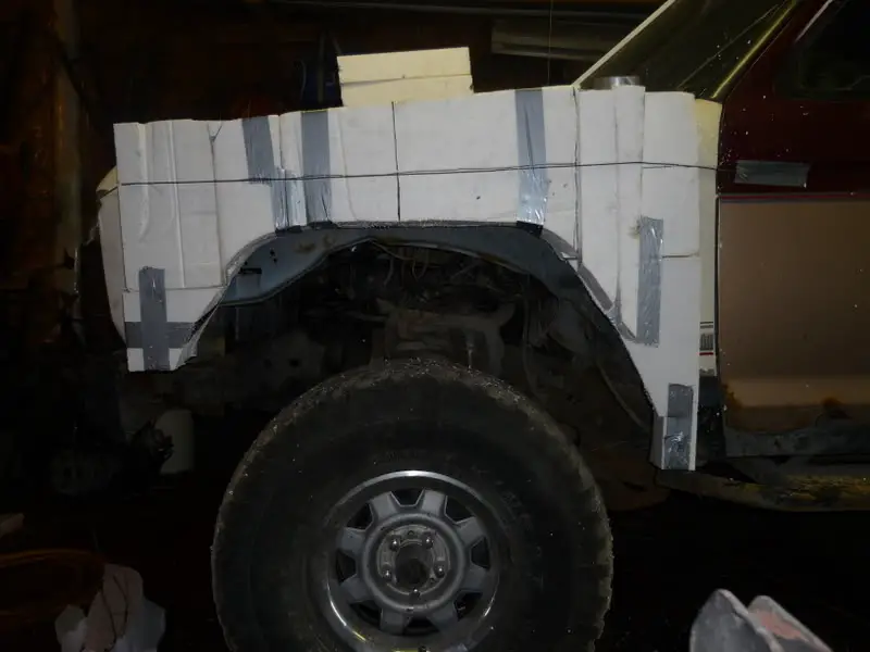

So I got the fronts bulked up and started to trim them to shape. I cut too much on the Drivers side and need to add to build it back up. I'll use the spray foam for that. So here they are taking shape.
Doh
The Drivers rear is cut out, waiting for fill.
