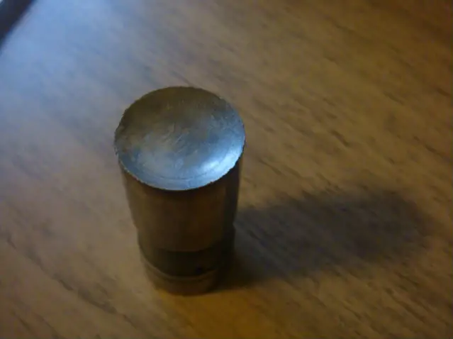

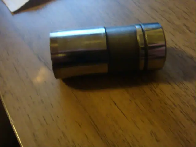

Case in point. Lifter looks squeaky clean.
Need I say more.
