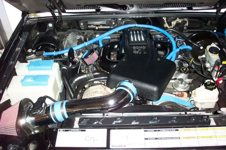

Looks is a good part of it, but it also bennifits by keeping oil residue off the TB.
Does it make a hill of beans of a differance ? I dunno, but it looks good :D
rubber grommet and permatex
That's the look I'm shooting for. Really wish I hadn't drilled that 5/8" hole in my K&N now but too late to cry now. I really didn't think about any options until I had so much trouble getting the breather tube to stay put. I tried a hose clamp but it doesn't really get a good bite on that piece of grommet sticking out of the intake tube. I'm going to try and plug that hole with something as flat as possible to try to keep the airflow as smooth as possible.
