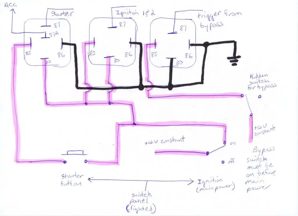

no i don't but i can draw it up and scan it then attach it here
i don't have a web address to upload it to. i can e-mail it if you like and you can post it

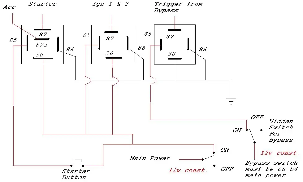

o.k. one more time
Looks better this wayÑ
sorry, new to the whole forum thing. thanks for setting me straight. funny it looks alot worse now that its up for the world to see. oh well it was a quick job. any way thanks again. Here's a better diagram.
