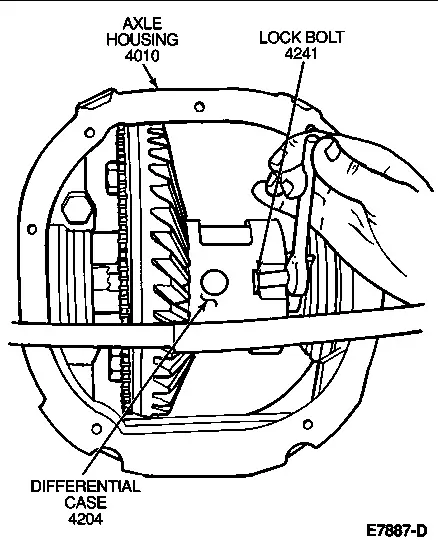

  1. Rear differential Remove lock bolt. Replace lock bolt after removal. If new bolt is not available, thoroughly clean threads of used bolt and coat with Threadlock and Sealer E0AZ-19554-A or equivalent meeting Ford specification WSK-M2G315-A5 before installation.

  2. I understand your axle is different..a little.. but the instructions are the same according to my manual

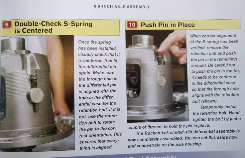

Thank you for this. I got that part but this...
Cross pin doesn't have room to go out, I need maybe 1mm or even less more for the axle to clear that snap clip from first photo.
