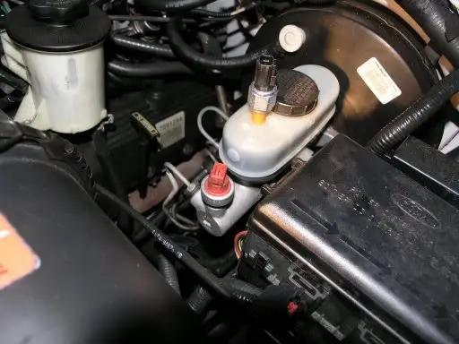

Cruise Control FIXED!!!
I had the same problem. After reading about many different things people have tried and expenses, I decided to bring it in under the $100 warranty deductable.
They fixed it in a day for what they lead me to believe was common enough problem that they had the parts.
Talked to tech. Turns out they they replace a brake switch in AT the Master Cylinder. From posts, I thought the brake switch at the pedal would be bad, but it was a switch at the Master Cylinder. Since it was warranty, I don't know how much of it was fake on the report, but they show they had to drain brake fluid, replace switch, then added fluid back.
Problem solved. Been working since like a new car. $100 for a switch - damn. Oh well, works now.

Just make sure they give you the black switch if you buy one, and NOT the red one.

The switch on the master cylinder is usually the culprit. Have the dealer run an OASIS to see if your truck needs the recall prior to purchasing the switch yourself. As stated above, make sure you get the black switch. (sorry michail1, didn't see your last post)

I am confirming it was the switch on the brake master cyclinder.
They replaced it with a Black plastic one. Obvious it is new.
