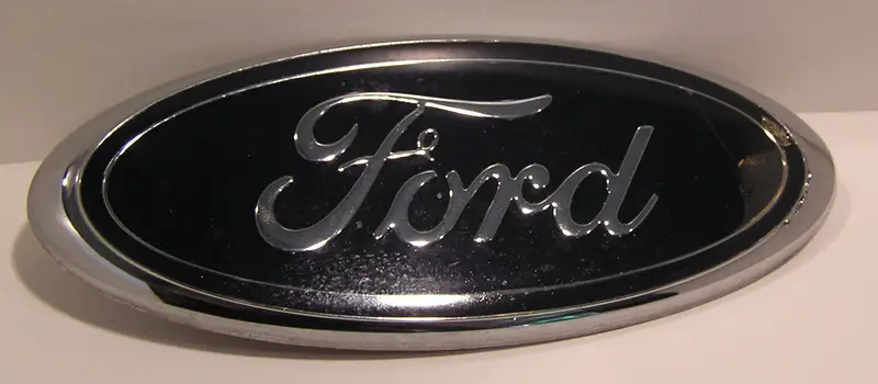

This did NOT work for me!! I was able to remove the front emblem using a heat gun and a screwdriver. After a few minutes of heating the adhesive softened and the emblem came off the truck pretty easily.
Then I put on my old man glasses and looked for the "seam" that would show me where to pry off the next section.....well never found it. I heated the sh*t out of the emblem (this is a heat gun, not a hair dryer) and it softened up nicely, I was able to put a blade in there and pry etc but this was not coming apart in any form that would let it go back together normally. I was mostly melting it and I think the blade was going into the softened plastic. In the lower corner of the top photo you can see where the blade was eating up the corner and plastic...not good. Then the plastic began to de-laminate.
I have an '02 and my emblems may be different? they are 5.75", standard Ford blue? My truck comes from Kentucky according to the label. Maybe different years and different trucks have different type emblems.
I attached photos of my front emblem and you can see where the boxcutter blade was cutting into the softened plastic but I found NO seam. Oh and ironically I took this off in order to paint it black and in this freaking photo it looks black just like I wanted! Except now I only have a f**ked up blue one! Sweet fancy Moses!
There is a LOT of confusion on this thread and lots of failed attempts....I think these emblems are NOT all created equal.
Good luck to those who succeed this, I will now have to buy or salvage another for the front.

I also have a 02 and it worked perfectly fine. keep in mind your peeling a clear rubber face off of a silver plastic piece. once it's warm enough, the clear rubber piece should just come off. and that's gonna be the piece that you'll sand the color off of and paint black.

Did you have a seam? A readily apparent seam? Some photos show a seam, others it is hard if not impossible to see. I heated my emblem a loooong time and once it was soft I was able to "pierce" the soft rubber/plastic. If you look close you will see the corner where I marred the chrome, and the clear rubber was tearing or ripping. Did you have any of these types of effect on yours?

I didn't heat my emblem. I used a small slot screwdriver for glasses to pry the edge just enough to get two bigger screwdrivers under there. Slowly work the two screwdrivers along until the emblem peels off. You could mask the edge to minimize damage.

you actually want to put the screwdriver on the insde of THAT lip that you scruffed. think of that little silver lip as the final border between the plastic/rubber and the silver plastic.

thanks for the follow up. I used a box cutter and the blade could have been part of my undoing. The blade seemed to cut rather than separate, I could not find a seam for the screwdriver so I used something thinner (a blade). So with your sweet little red arrow, I will scoop up some of these at a junkyard and try again. I will heat more, use flat blades to "lift" and see what happens.
