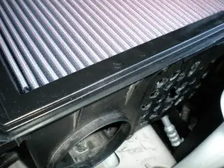

Here's a fairly cheap mod that i did to my X...
take your factory box...
***** everything is done on the bottom half of the air box *****

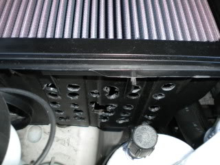

1. remove the silencer tube from the box.
2. then drill holes with a large drill bit or w/e you have, on the front of the lower portion of the box like so...
* I ended up cutting the edges of the holes, and just having an open face for better free flow air...
3. I did drill holes on the fender side of box.
4. I drilled holes in the back of the box as well.
***** i did NOT cut the side of the box facing the engine, cause it acts so what of a heat shield *****
5. Put in a K&N Panel Filter.
This will def make your X sound meaner, and you will feel the little punch of power lol

just did it over my lunch break!lol took minutes. I noticed an immediate difference in sound. I recommend everyone do this. I drilled in the same spots you did. I then just ended taking a dremmel to those spots and just cutting a giant hole in that place. Much more of a deeper sound!
Didn't really notice that much of a performance difference though.
I will report back if I get any mpg advantage.
