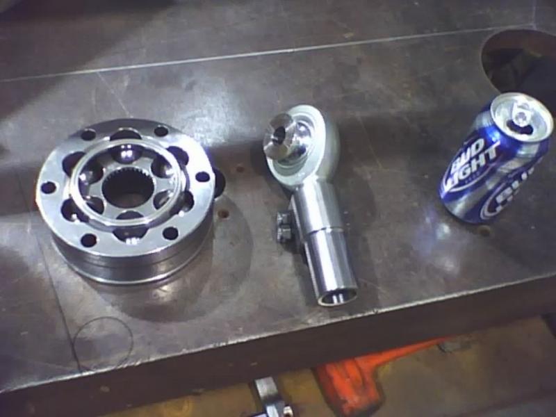

All theory:
I think the reason why is that at high speed turns and no disconnect mechanism (like lock-out hubs), a U-joint-based axle shafts will clunk as the U-joint's inertia moving back and forth exerts a force on the axle shaft and the angles of the two U-joints are not in sync to cancel each other out. In a true CV axleshaft (the "ball and cage" design), there is no back and forth motion as the parts are rotating around an axis that does not change.
CV ball-cage design:
Single U-joint shaft - stare at the center of the U-joint, notice its also wobbling at the same time its rotating.
