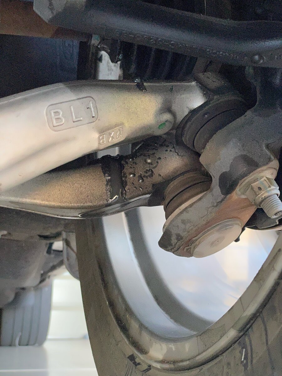

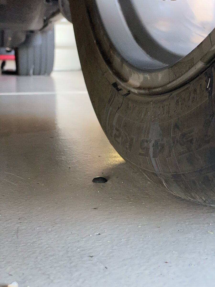

Notice a black liquid on the floor of the garage under the inside of drivers side front wheel. Here is what it looks like:
It's scheduled to go into the dealer on Tuesday morning.
That doesn't look good. 2nd pic looks like boot at the small clamp has excessive grease or is torn. Have you run anything over recently? Bag or branch? Be curious to see if they will cover without issue.
There was some information that the clamps were too tight when the axle shafts were manufactured, eventually cutting into the boots.
Can't say that's what my problem was, but I checked and a new axle shaft was installed as there is no reliable way to repair the boot over the CV joint.
TBill
^ I can see the reason to get a new axle as a warranty repair, but isn't the reliable way to repair the boot, to just replace the whole boot? I mean if you can find one that fits, a normal boot not the split down the side, slip on type.
After a month of clicking when stopping and accelerating I was just told the half shafts had no grease. 10,800 miles I'll pick up some butt lube later today while I wait for the next problem.
^ Huh? Isn't it covered under warranty? If you ran a month without lube, seems like it'd be better to replace them rather than relube, as long as the replacement is motorcraft rather than a generic.
