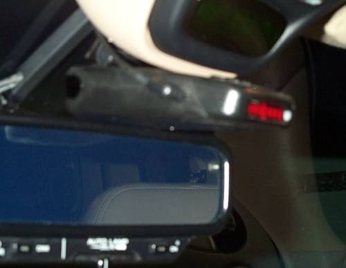

I took this mirror out of my 96 X that was totaled. Notice the on/off button to the right of the slider. If yours doesnt have the button you can probably get a mirror from a junk yard.

My mirror actually has a slider on the bottom instead of buttons like yours. Its slid all the way to the left (off) but it turns on no matter what now. It just started happening. BTW- what brand radar detector is that?
