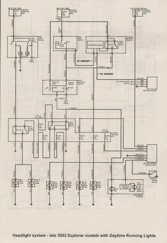

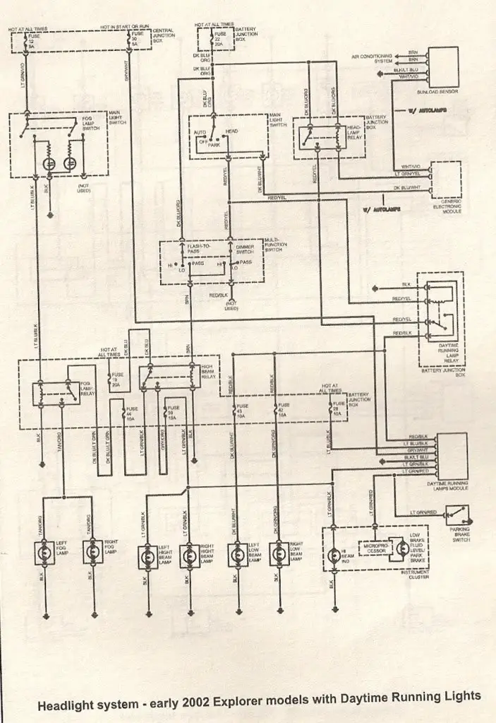

Anyone know where the daytime driving light module is located on a 02 Eddie Bauer. This is a Canadian vehicle. Mine is intermittent and would like to find it to troubleshoot to repair or replace.

Drl
Thanks for the info. These things have ocasionally not worked for a couple of years. Don't seem to want to work at all now. I will check out those items. Thanks again
Daytime running lights
All fuses and relay checked out O/K. Found these also identified in the manual. Does anyone know where the relay gets it's control power from?
Here you go, from my Haynes Manual:
Daytime Running Lights
Thanks. That will help a lot in the trouble shooting of this system. I am going to have to find a manual for this vehicle as I plan on keeping it for a while.
