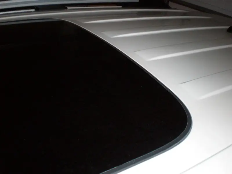

Although I don't know for sure, I highly doubt that you can get a moonroof similar to the OEM one. On older vehicles I have seen them added when they were referred to as a 'sunroof' but they were all manual tilt ones without shades. A moonroof is not listed as an accessory and the roof of an Explorer without a factory moonroof is different. Your roof has the 'ribs' from one end to the other while the ones with a moonroof only have them at the back with a tapered end at the moonroof. I doubt a 3rd party would even want to attempt it. Also not sure what it would do to the integrity of the roof.

The problem is going to be that the roof isn't flat. That will make it near impossible to seal because you will be cutting through those raised 'ribs'.
