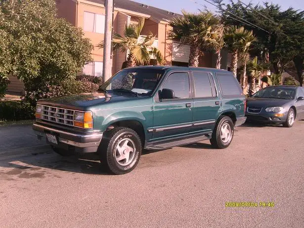

1994 explorer 157k miles
i have a 94 explorer and as all you know i did a compression test on my cyls i got 120psi all around except i couldnt really do that last cyl on the passenger side by the fire wall. is 120psi instead of being 170 or 180psi means i have alot of miles on the motor? if so should i find a lower mile engine? my mechanic gonna charge me 500 dollars in labor to replace the head gasket sets and getting the heads checked out and cleaned. so i wanted to ask for your opinion. thanks im just really confused right now not sure what i want to do. a used engine with alittle bit lower miles would be between 500 to 800 bucks and 450 to install. thanks
That is a very clean X and if you are planning on keeping it you may want to get a quote for a rebuilt motor or getting your current motor rebuilt. It might cost a bit more than installing a used engine but you would at least be confident that the engine would not develop issues in the near future. The other option is pay the $500 now and just run the motor into the dirt and then replace it.
