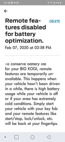

I have had my 2020 Explorer Platinum about three weeks. I recently left it in the garage for a trip (6 days), and on the return flight home I received a "Deep Sleep Mode Activated" FordPass alert on my phone. When I got back to the car, it would not start or respond, and acted like it had a completely drained battery. I was forced to jump it to get it going (last night).
I've triple checked for lights or other accessories on, and found nothing. The auto-start stop also seems disabled, which makes we wonder if there is a battery issue. Unfortunately, I just received another such alert, and am now wondering what to do next on this Labor day weekend. Anyone else experienced a similar issue?
P.S. I dare you all to figure out how to remove the battery on this vehicle.

Did anyone get another Deep Sleep notice today? I got one just before 7 Am this morning. I hadn’t driven it since Sat afternoon and battery is fully charged. Should only do that if 14 days without a start or battery voltage drops below 9.5 Volts. Sounds like FordPass is having a some issues
