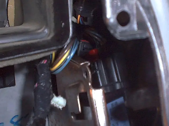

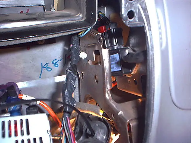

Ok, I am doing the Brown wire mod, using the brown wire behind the dash, but I can't find the harness like posted in the pics above. I have a '98, and it looks different than the pics of the '97. I was about to cut the wire, but it looks like it goes to the passenger air bag (although the wire colors are the same as above). The last thing I want is to set off the air bag :banghead: I thought I better see if anyone can help before I cut any wires. Just out of curiosity, how much $$$ is an air bag? I've heard they're pricey.

I take no responsibility for your airbag but I'm pretty certain that you have identified the correct brown wire. It's been a while but I seem to remember my 98 4dr looking just like your pics (and not like the pics posted by Jared for his 97). As I recall, it was the only brown wire in the area.
If you are unsure, you could try disconnecting the battery for 15 minutes (to remove the charge to to the airbag) and then cutting the brown wire and temporarily splicing in a lighted switch or lit circuit tester using alligator jumper wires. Reconnect the battery and take the X for a ride. The juice thru the brown wire varies...it's always partly on (dim light) and increases as more power to the front wheels is needed (juice increases and light gets brighter). If you jump on the gas you should see the light pulse brighter as the computer calls for more power to the front wheels. If this happens then you have found the correct brown wire. Having said this, I really don't think its necessary since I think you already have found the correct wire.
Lee
I'm still unsure if that is the correct wire. If you follow the wires in the 2nd pic. they go to a black harness, which is connected to a metal bracket that surrounds the airbag. Also, the red thing on the harness can be slid up and down. I don't know if it is a switch of some sort, or just a way to lock the harness. I know there are other people with 98's that have done this. I would appreciate a little more feedback. Thanks.

Okay, while you're waiting for others to chime in, I just pulled my radio to take a look. The brown wire you have identified is the same brown wire that I tapped into to do this mod. It goes into a black connector along with a black, yellow and light blue/black striped wire. If you take a look at the original 25 page+ brown wire mod thread it talks about this 'gizmo' (I can't remember what it's called and I'm not wading thru that thread to find out) that sends out the signal from the computer to the transfer case. It has the famous yellow wire connected to it as well which was talked about in the first few pages of the original brown wire mod thread. So IMO the thing you think has something to do with the airbag is actually the 'gizmo' I am referring to.
Have no fear about setting off the airbag because I am confirming that that's the same wire I used and my airbag is fine (although I did disconnect the battery when I did this mod only because I wanted to be safe and not sorry when working near the airbag).
So it's either that you found the correct brown wire or I have been driving around for the last 8 months like an a$$ thinking I'm in 2wd when I'm not.
Lee
Wow, thanks a lot for the reply. That definitely clears things up. I read through the whole 25+ pages of how to do this, but it didn't really help much until I got towards the end. I still don't understand that gizmo thing. I looked at it pretty close, and saw that the harness plugs into it, but no wires come out. The only thing I can think of is that it might be some kind of little computer, or chip.

One last post on this issue from me mainly because I want to clear up my unprofessional and inaccurate term 'Gizmo' for future readers of this thread. I had a little time tonight and went back into the original brown wire mod thread. The thing I called Gizmo earlier is actually the Torque on Demand (TOD) Relay. Here's a cut and paste paraphrase from Dogfriend located on page 7 or 8 of the original thread that explains it a little better:
'What does the brown wire come from? a relay??
Yes it comes from the Torque On Demand relay which is a solid state relay located in the dash (upper passenger side dash).
The Torque on Demand relay is a solid state relay. It uses the signal from the GEM (the infamous yellow wire behind the dash) to modulate the current in the Brown wire which goes to the transfer case clutch coil.
Four wires go to the Torque on Demand relay: Ckt 274 (Y) from GEM, Ckt 400 (LB/BK) 12V from Accy Delay relay, Ckt 57 (BK) Ground, Ckt 779 (BR) the brown wire supplying the Clutch coil.'
Hope all is clear now.
