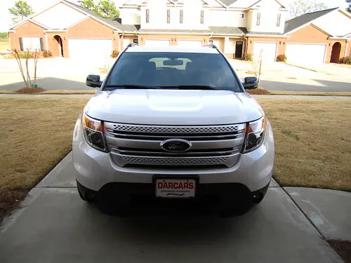

I went out of state to get the exact 2011 Explorer I wanted. Just so happens it has a Front License Plate Bracket on it.
These are installed during manufacturing with plastic rivets.
Here we go!
Tools needed:
-Screw Driver
-Drill w/ assorted bit sizes
-2 Trim Retainers (I bought mine at Advanced Auto Parts)
Remove Plate
Plastic Rivet
Use a Drill w/ a Small Drill Bit to drill out the rivet
After that use a Flathead Screwdriver and pry the Rivet out
After the plate is removed
Trim Retainers
Installed Trim Retainers
Old Rivets
Scratches from the Vibration of the Bracket
NXT!
Bracket
Finished!
Hope this helps!
