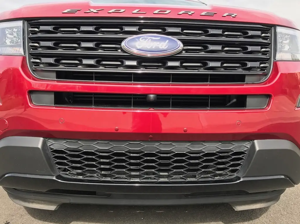

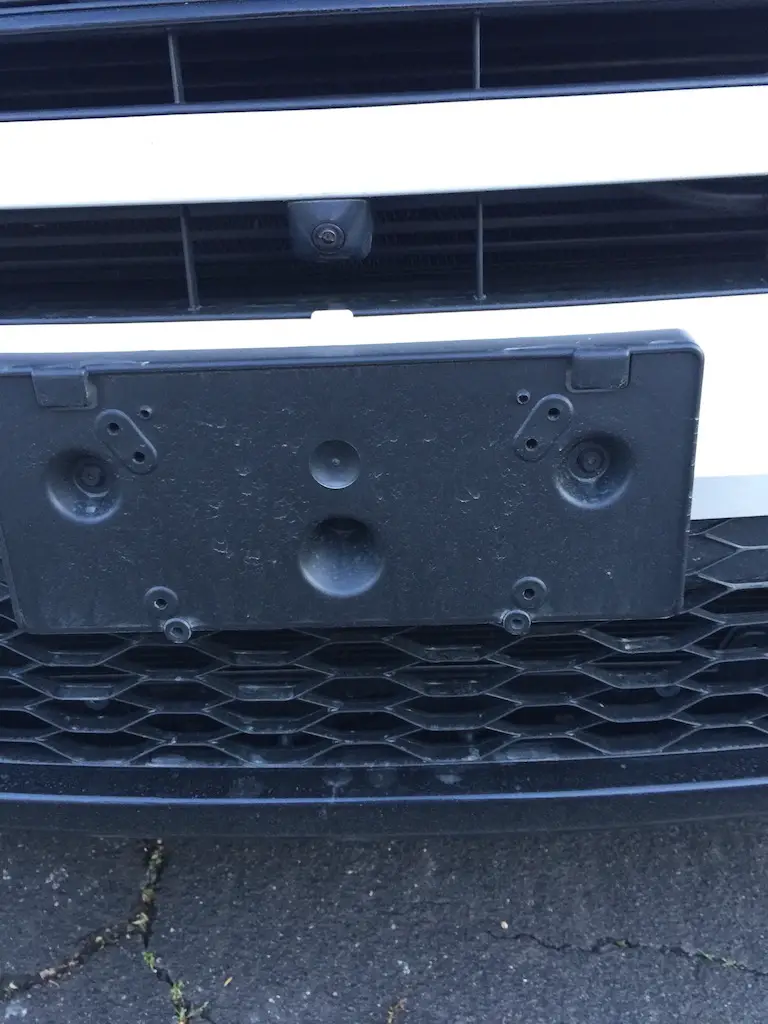

For anyone with a '16 and interested if the procedure is the same, it is! Although there are 3 holes instead of 2. I just did it to my '16 Explorer Sport tonight, and it took about 60 seconds to do it. I didn't even need a flathead screwdriver, it just pulled right out. But for those who may want/need some extra leverage, the flathead screwdriver would definitely help. :)
All you need is a 7/64 inch drill bit. Once you're all done, you'll see there are 3 perfectly clean 1/4 inch holes behind the bracket from mounting. The drilling was really easy -- pokes right though.
I still need to order trim retainers, but I wanted to make sure I knew the size of the holes before ordering. Confirmed the 6.4mm retainers (1/4 inch) are the right ones!
Pictures (and a video) below showing: the '16 bracket on, a video of me drilling a 7/64 inch hole, confirming the 1/4 inch holes behind the bracket with a 1/4 inch drill bit, and what it looks like after.
HUGE thanks to Bubz! for starting this thread!
DRILLING VIDEO
BRACKET ON (3 RIVETS - SIDES AND LOWER CENTER)
RIVET (BEFORE AND AFTER DRILLING 7/64 INCH HOLE)
AFTERWARDS (1/4 INCH HOLE CHECK, CLOSE AND FAR SHOTS)

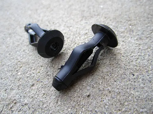

Are the original holes from the OEM front plate holder threaded? The attachments that came out with the OEM holder appear to be a type of expanding retainer similar to the ones used to hang things from drywall. I just want to be sure that the new, smaller plate holder is secure.
Are the rivets used with the OEM (see pic) available as a part and installable w/o special tools? Think similar looking drywall expanding fasteners might work?
THANKS
That was from my 2014 Sport and its long sold so I kinda remember that those holes were not threaded they were just pressure fit snap in style. Those clips look very familiar, when they press in does the center pin push up level with the head?
I remember drilling mine out as opposed to pressing in a pin.

In looking at Bubz!'s photos, I come to realize my front plate holder is installed upside down (retaining tabs on top, plate scews on bottom). I'm starting to think I got a truck built on Friday.
That's the way mine is installed.

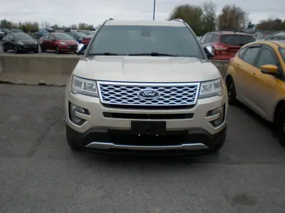

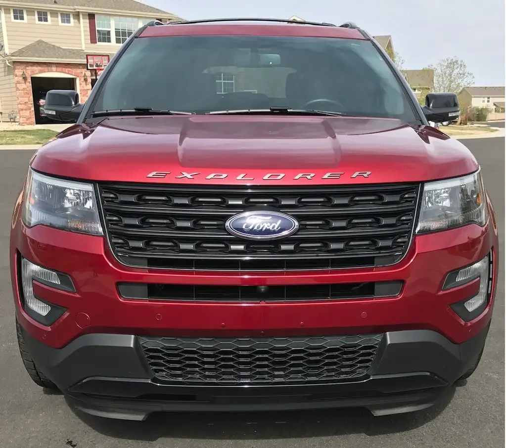

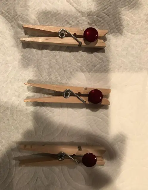

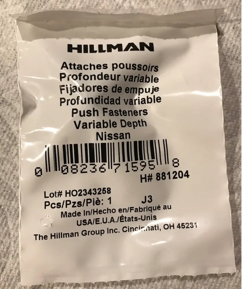

I did this a few months ago.

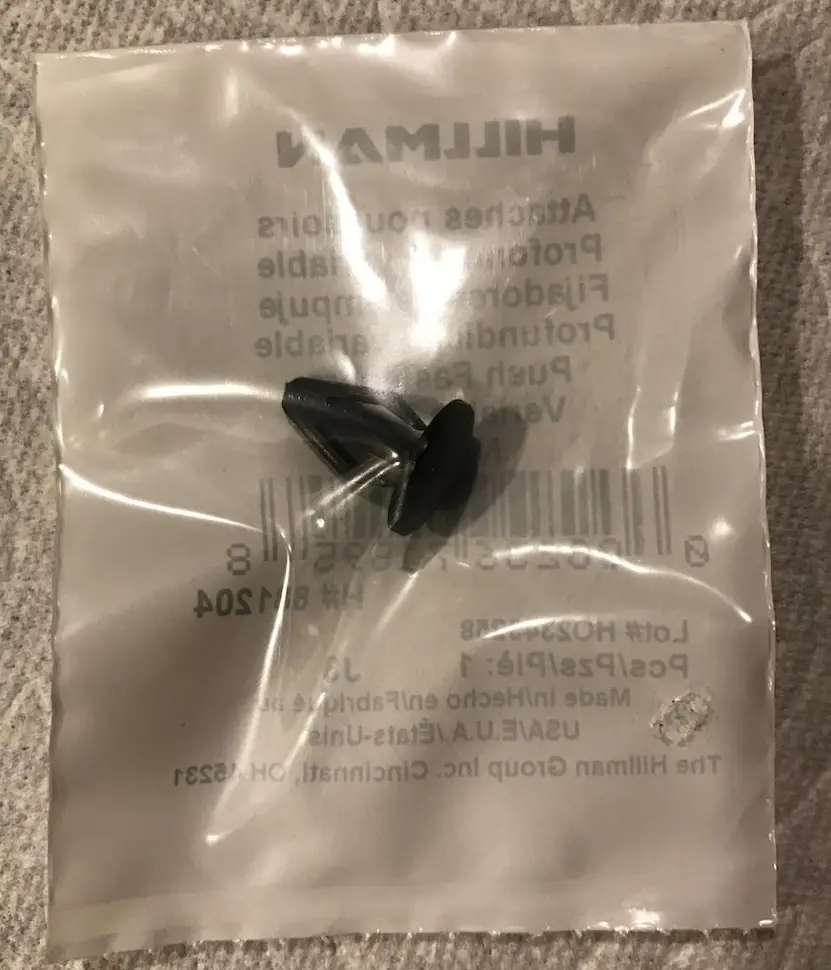

I purchased the clips at Lowe’s, item J3
Then painted with Ruby Red touch up paint. I used 3 coats
Installed. They have been installed for 18 months and still look great, although pictures below are from 3 mouths, survived winter driving in the mountains, without any issues.
I followed the instructions and now I am front license plate free as well. The front looks so much cleaner now.
