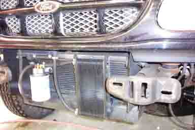

Here is my set up.
The filter is a Perma-Cool filter. It comes with a temp guage.
To the right is a B&M after market cooler, and directly above the filter is the factory cooler.
All these products can be purchaced from Summit Racing.
A little handy work to make some brackets and you'll be set.
