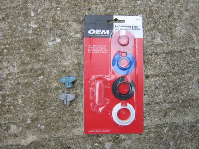

Go to Autozone, buy this tool kit, use the baby blue one (outside of the package in the pic below). The lines disconnect by pushing in towards the filter, then pulling out. You'll be done in 15 minutes.
Actually, it's the gray one (smallest), at least on my 2000 Explorer with 5.0L.
the tool needs to go in ALL THE WAY in order to release the garter spring. If you insert the tool and the filter still doesn't release the tool is NOT in all the way. Use long nose pliers if you need to force the tool in more.
