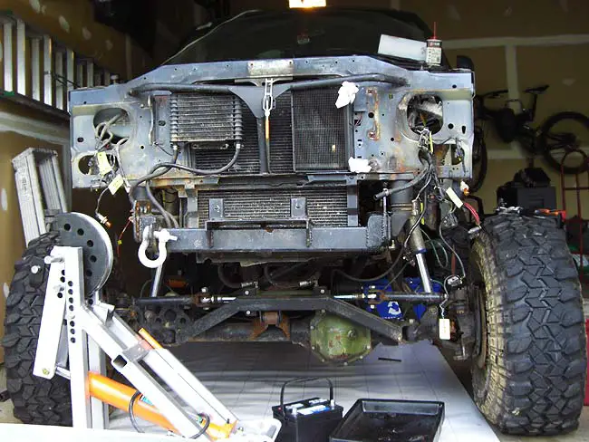

Some 1st gens did - in the pic below, the cooler on the driver's side (rotated 90 degrees) was pulled from a 1st gen, the one on the passenger's is the stock one that came with my 2nd gen. In comparing the two, the 2nd gen's appears to have a better cooling fin design.
I gotta find one of these as well...................... its only single pass so maybe I can find something to rig up instead of buying one from the dealer for $100+
