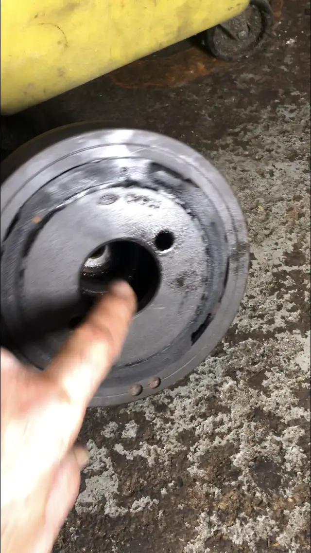

Check the harmonic balancer pulley on your crankshaft. Sometimes it starts to come apart and make awful noises. With my engine OFF, I was able to stick my finger in the bolt hole and could actually feel loose pieces stuck in there.
If so, that’s a pretty easy repair and I did a write up with pictures on here about 2 years ago
Thanks Mike, replaced the balancer with OEM not too long ago.
Yes I remember, you did it from above, I did it from below on a lift at my sisters house. But that noise on the video in this thread sounds like it could be the balancer

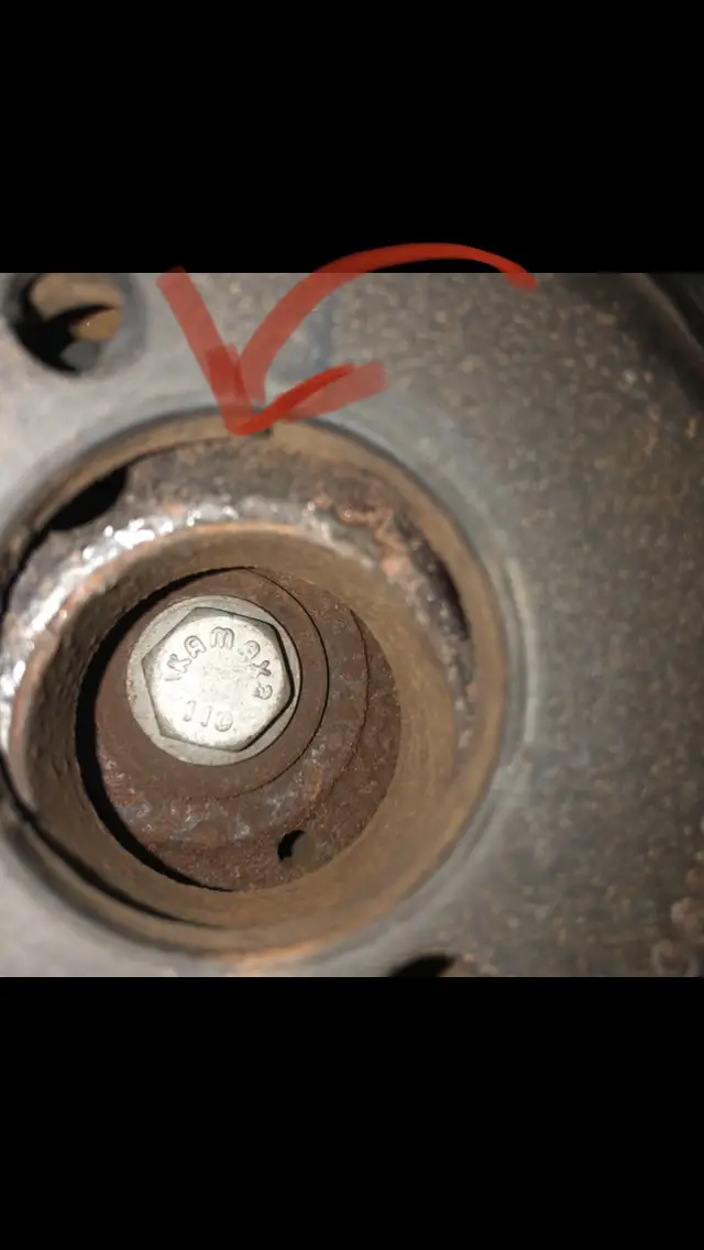

The harmonic balance is bolted to the crankshaft, and WILL spin even with the belt off. I’m not convinced that is the source of the noise in your case, but mine sounded pretty similar when it went bad.
If you lay on the ground under the front bumper, you can reach up to the balancer pulley and stick a finger into the Center bolt cavity and feel around for any loose chunks of steel weight. Nothing should feel loose. Takes 2 minutes to check. Here’s a picture of mine with red arrow showing one of the loose chunks stuck inside.
