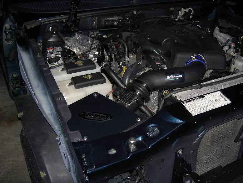

Try to find a Volant air cleaner, that was the best one made for these 95-01's. It was a 19640 part or similar #, I have that in my 99 4.0 truck. That's a cold air filter system, it pulls air from the OEM headlight area.

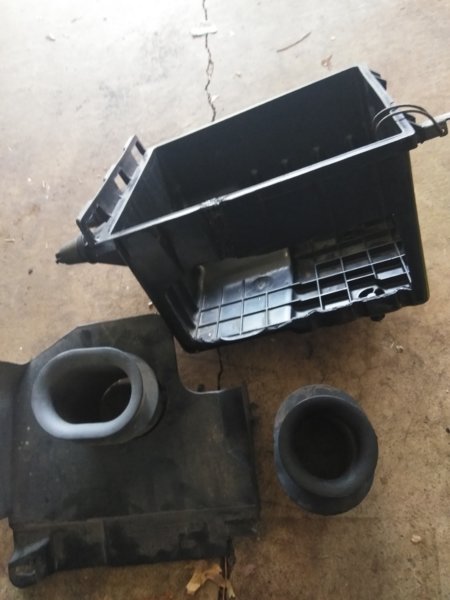

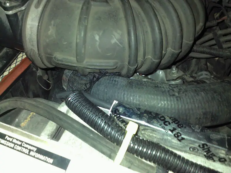

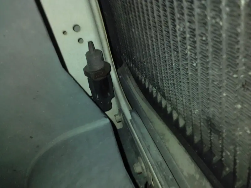

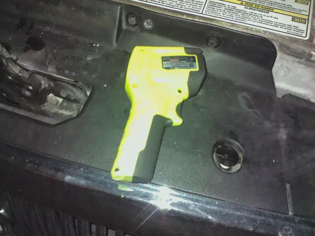

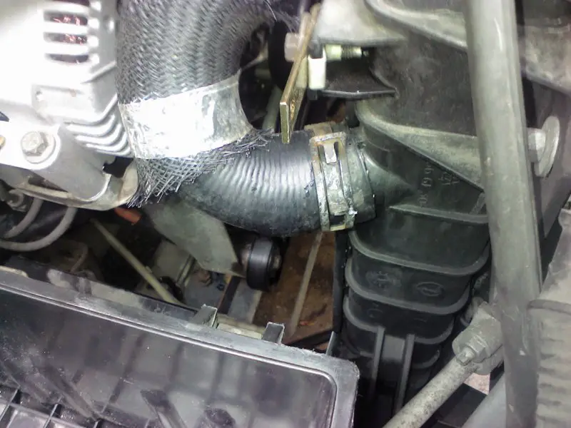

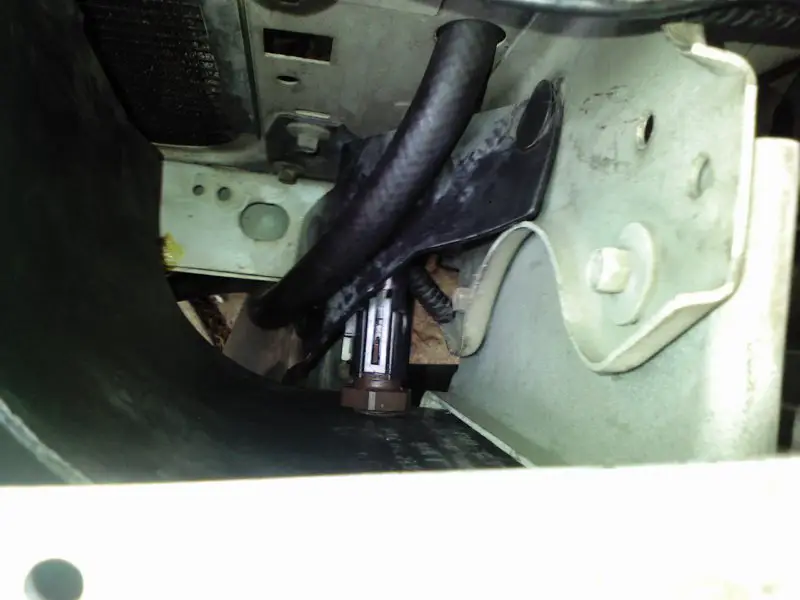

Poking around with my trusty Ryobi IR Thermometer I found that the Upper Rad Hose was transferring heat to the Intake Snorkel - Just as it is in OP's pic & probably every 302 out there - SO>> I'm shortening the Hose where it connects to Rad to get it OFF the Intake Snorkel - I agree OP does not have a CAI setup in that pic, more like a HAI - As Don said above I'm thinking one wd have to go straight down under existing Filter Box like a MKVIII or Town car to find some cool air and/ OR into the Fender area behind the Parking Lites like 5.4 Expys & F150's - At best our existing Filter Box opens to a SMALL 'sheltered" area directly Forward - On my 302ci 2001 Mounty the IAT is NOT in the Snorkel like many cars - It's on driver side behind grill in front of AC condenser - Certainly getting the IAT in a place where it sees the COOLEST ambient temps possible should help performance across the board …. MAYBE even gas Mileage performance ~!

I shortened the Upper Rad hose & got it well off my Intake Snorkel.
I moved my Ambient Air Temp Sensor to consistently Cooler location, again my 2001 Mounty has no "real" IAT.

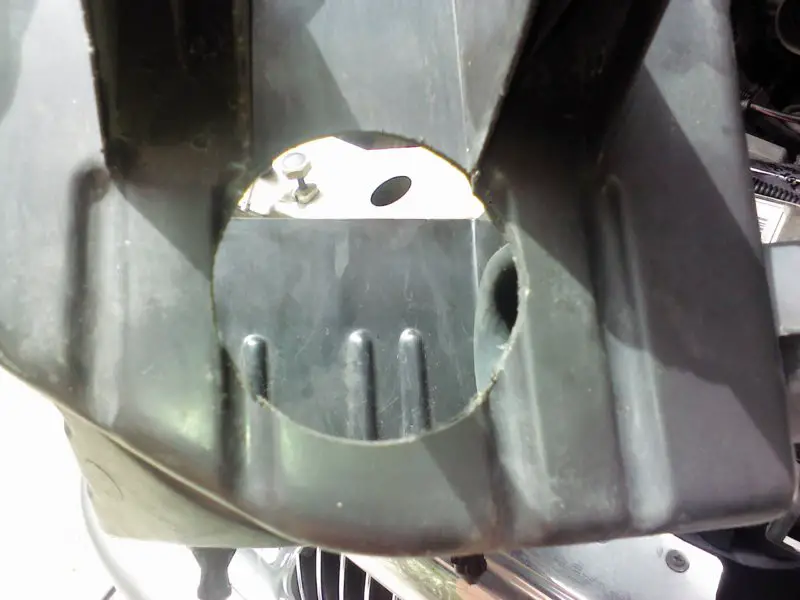

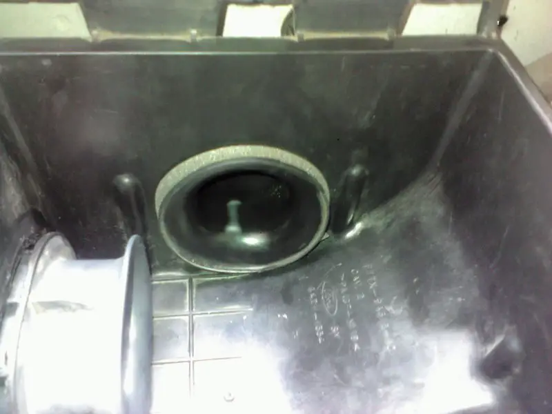

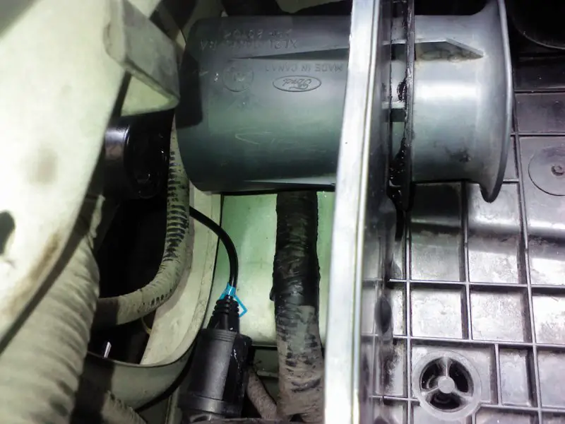

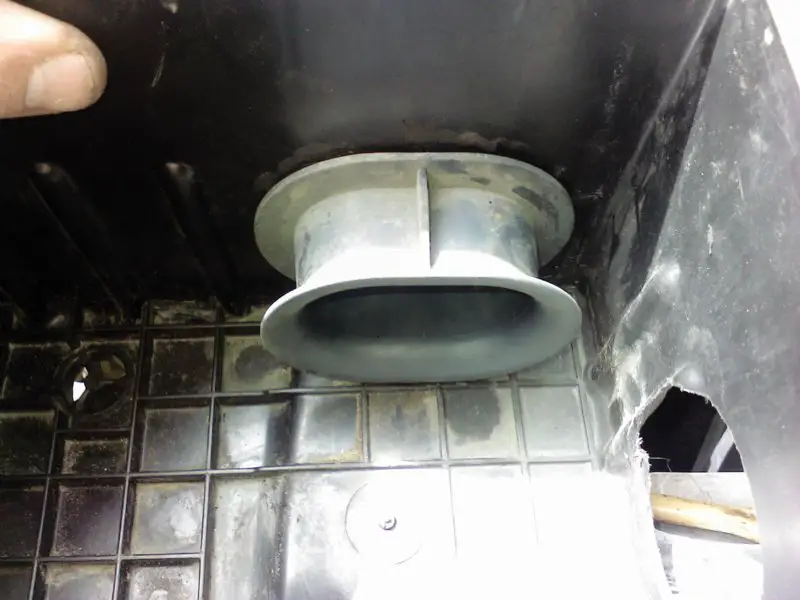

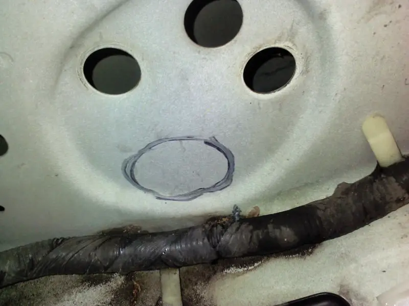

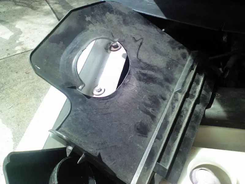

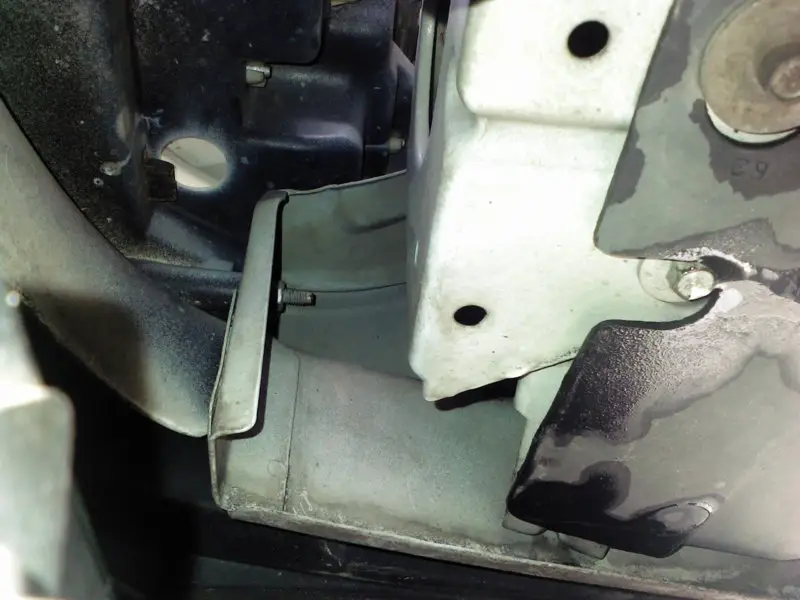

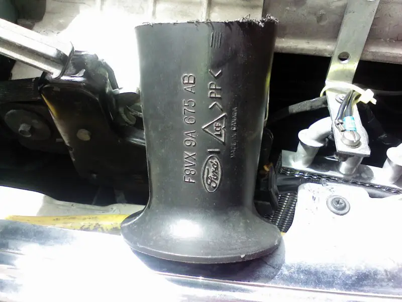

Stock Air Box just sits on a shelf so NO cooler air is under there - Don was right as usual so I went thru Inner Fender Wall into Fender area behind Parking Lite & made new hole in Stock air Box, fitted an Air Box Inlet Horn that kinda "fell" off my 2002 TC during its Air Pump delete & Air Box Mod & reversed the fitment of Stock Airbox Inlet & deleted the Facia piece behind Pass Side headlite for more cool air on that side of Engine Bay.
