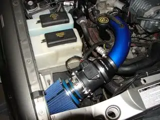

i got all the parts at an orielly auto parts store i believe the rubber boots were 11 a piece and the maf adapter which is for the 90mm lighting maf and it was 14 and the filter was 30 which is good for 100000 miles and can be recharged, then i used a piece of 3" exhaust pipe i have a ton of these lol from when i used to work at Winnebago and i got some metallic blue spray paint and painted it to match the filter and drilled a hole and put a rubber garment to hold the line in.
Kudos again. You did a great job. Many of the homemade setups I've seen look homemade. How did you secure the MAF/filter in place? The MAC comes with a great MAF adapter with two plugs that fit where the stock airbox used to go to hold everything in place.
