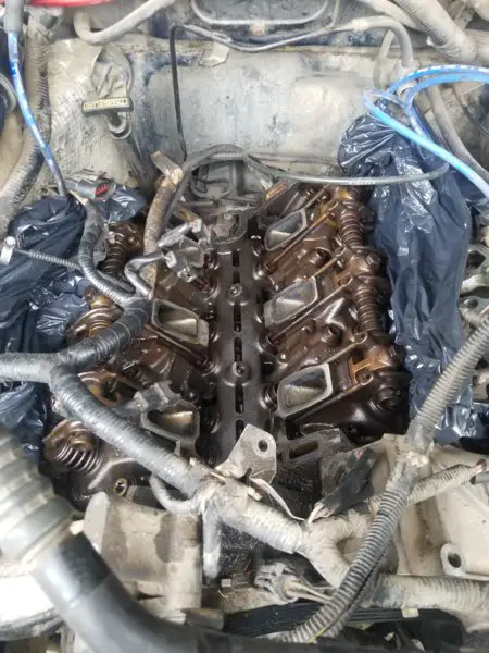

Is there anything that I should check/do as I replace the lower intake manifold gasket?
You could use the opportunity to check the rockers and pushrods for wear.

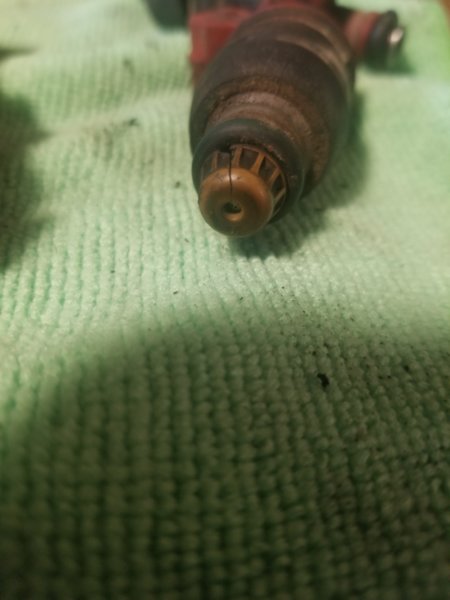

Sweet thanks, also, I have a max trim level reached left side, I have swapped injectors side to side, replaced 02 sensors, cleaned maf sensor, and replaced the coolant temp sensors, no change, searched for vacuum leaks, but could find none.
