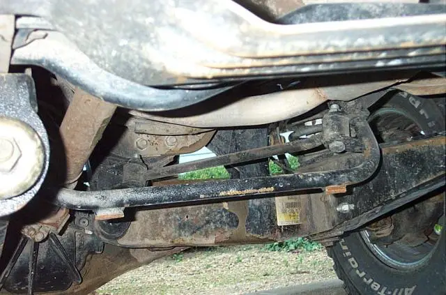

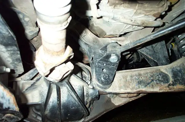

Hey Pete do you have a pic of the driver side axle drop bracket?(The one thats on the passenger side but to the axle for the driver side tire.)
the full shot..

TDavis... Pics weren't workin for me... Plus, if y'all went with Skyjacker from the beginning, threads like this never woulda happened! :p

Where exactly is the brkt breaking? I am using the old style drop brkt which was basically a flat plate and you just bolt your old axle pivot to it. I heard that superlift had come out with new style drop brkt for the passenger axle. Is that the ones you guys are talking about breaking.
Hey Tom, I'm breakin the bracket in the front. The driver side axle to be exact.
You got any ideas of how to strengthin this bracket?

My buddies that have Superlift did the following. One of my buddy is the giunniea pig for all the gear. Essentially #1 gets the stuff and #2 observs what is happening (kind of behind the scenes) #1 is super rough on the ol ranger 95' or 97' and has broken much of the lift. Flying off 5' drops and the such. Breaking axles and all.
So what #2 did was see where the brackets were breaking and took his (#2) lift in to a welder before he put it on and had them beef it up a bit where #1's were breaking.
If these are the same lift (likely) the weld is only on one side of the joint.
Bust out the paint pen and mark where you want another bead laid down and take it to a welder.
Voilia you have strenghthened your lift, as well as increased chances of breaking something else that the lift breaking would have saved but that may be worth it.
Cheers hope it helps...
Yes.
Which side of the that bracket is it breaking?
On the front? Have a gusset welded in.
On the back? Little more difficult, since that's the side that TTB moves up and down... but welding the gusset on the front could help the back half.
