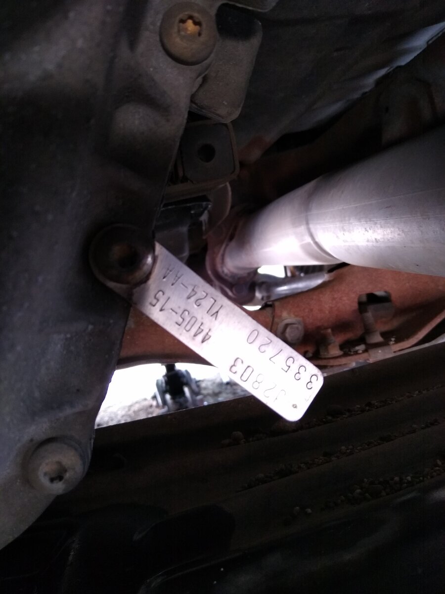

I did crawl under the truck and changed all my fluids, waited until new motor in and truck drove good as it was dead when I bought it, so I learned I got a 4405 transfer case, after digging learned that it is an Automatic 4 wheel drive system, but was told by ppl that only v-8 had the awd system, I did go to kelley blue, and edmunds and typed in awd with SOHC 4.0L and both sites listed as options, at any rate the v-8 is above my skills w/out research and I'm perfectly happy with the v-6, install a pre-oiler and done. As for the O2 leaning towards the no weld bung 1sicbronconut mention or buy a welder maybe both, as I would like the cat efficiency to be monitored, plus fires start easy here in NE NV, just want to say Ty to everyones ideas/help, may have to start thread on the 4405 AWD issue on 4.0L SOHC.

I thought 4.0 SOHC had a 1354 TC.

Great directions and thanks but my O2 sensor bung is not there, I was prepared to do just as you instructed bought the socket, O2 sensor, as I only read the codes, again new to me vehicle and want it as close to perfect as possible, only to learn that the PO replaced that section of EX and eliminated it altogether, as for the transfer case I too heard/read ALOT about it but my tag clearly states 4405, here the pic I took of it and this is on a 2001 XLT 4.0 SOHC, then again alot of confusion esp on my part would be that I'm talking about AWD as in Automatic Wheel Drive, and others maybe referencing All Wheel Drive, I'm not 100 on if FORDs version is called Auto rather than ALL, like the whole Traction Lok/ Limited Slip thing or not so maybe some confusion on terminology happening, not really sure on that, or could be that.......????? I do know that my X 4.0L SOHC has a 4405 TC and that is the Automatic Wheel Drive version.
Update was terminology mix up on my part thanks for correct info earlier everyone!
