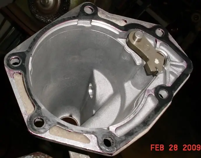

1.The pawl WILL hold the weight of the vehicle. 2.It's NOT a $.05 sliver of metal. 3.The trans will NOT have to be disassembled IF it ever broke. Rarely do you ever hear of a pawl breaking and if it happened to it's in the tail housing on these transmissions and can be easily repaired.
