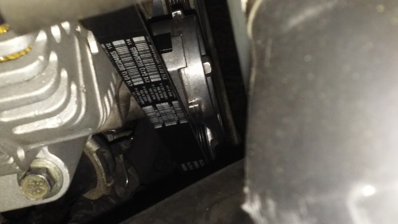

I also did a test on the tensioner s with a beem style torque wrench
them tensioners spring s have ten pounds of force in any position
I would take a pic of my tensioner with that belt but it's hailing out now sorry many later today

Ok because of my dedication to the forum and shoc owners I went and took a pic :)
