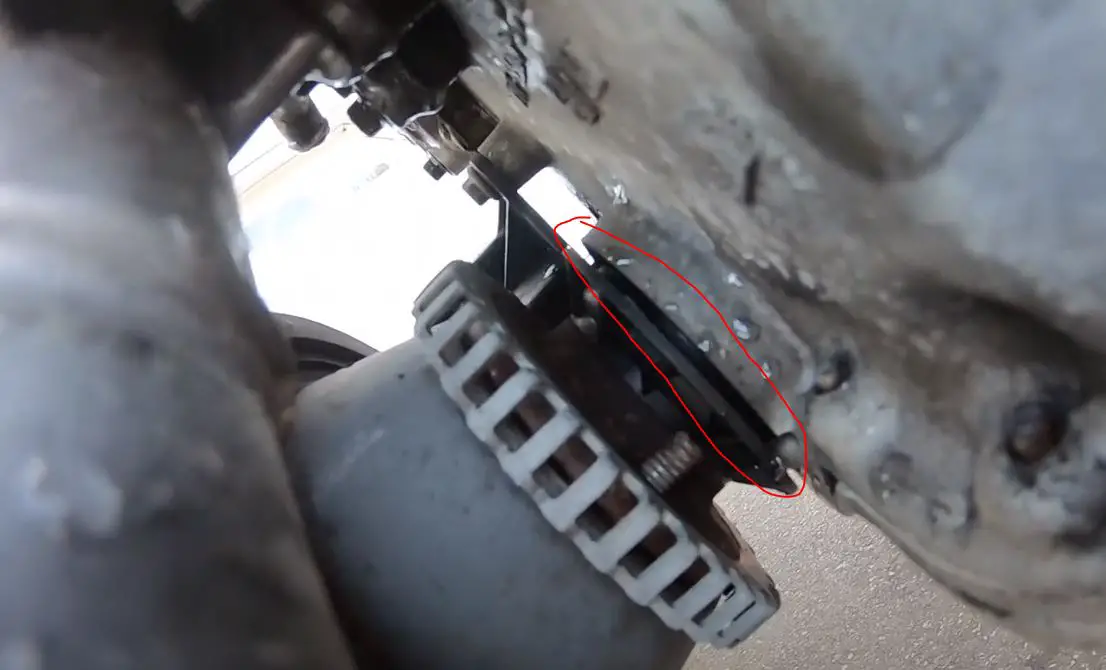

This is the gap he is likely reffering to. It looks like this gap is normal when the harmonic balancer is on tight. For those with the same truck as me, do you have a gap where circled in this pic like this one does?
This is not my truck, I pulled this screenshot from a Youtube video of a guy pulling the balancer off and this is the state it was in fully on tight.
